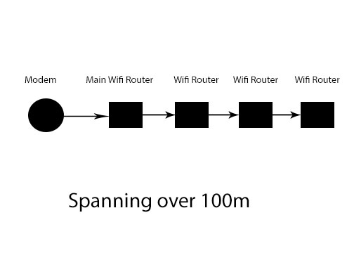

  3. Daisy Chaining Routers 4 times Is it possible?
    Hello everyone,
    If I want to extend my wifi network in a daisy chain format but instead of 2 jumps i'll be making 4 jumps. Is this possible? Uploaded a diagram:
    Michael1984, Jun 8, 2021
