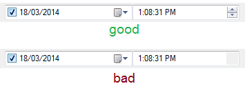

    I have a bug in my application where the up/down spinner on time pickers disappears occasionally.
    Date/Time picker does not re-draw the up/down spinner ba205802-fe5c-4a8d-a92c-be76aa84cc50?upload=true.png
    I found that it occurs whenever InvalidateRect is called on the parent window.
    Here is a simple reproducible example. I've tested on Windows 7 and Windows 10, and get the same result.
    Does anyone know why this is happening? Is it a bug in Windows or am I doing something wrong?
    Some one suggested to use the WS_CLIPCHILDREN style, but I don't think I should need that. Windows should properly re-draw the spinner. Using that style does fix the problem, but only when I apply the style to the parent of the date/time picker (rather than the picker itself) and that then causes group boxes to not draw properly.
