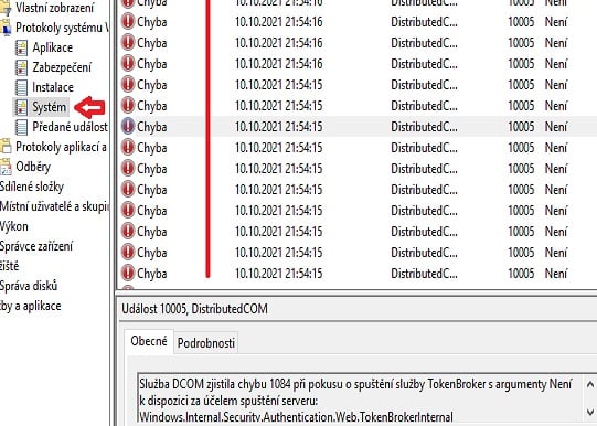

    DCOM detected error 1084
    My PC: GIGABYTE B450 GAMING X Sapphire Radeon PULSE RX 5500 XT 4G OC, 4GB GDDR6 Transcend 32GB (4x8GB) DDR4 2666 AMD Ryzen 5 2600 Seasonic Focus GX 550 Gold SSD disk Kingston A400 240GB 7mm HDD WD 3.5" 1TB If I install the driver on the graphics card, the screen will black and the PC will not boot. It can only be started in safe mode, even with the network. Event Viewer (system)
    DCOM Error 1084 Event 10005 348376d1633899073t-dcom-detected-error-1084-a-1.jpg
    DCOM encountered error 1084 while trying to start the ShellHWDetection service with arguments Not available to start the server: {DD522ACC-F821-461A-A407-50B198B896DC} DCOM encountered error 1084 while trying to start the WSearch service with the Not Available argument to start the server: {9E175B6D-F52A-11D8-B9A5-505054503030} DCOM encountered error 1084 while trying to start the TokenBroker service with arguments Not available to start the server: Windows.Internal.Security.Authentication.Web.TokenBrokerInternal Grafic card: Device not running (amdkmdag) Device PCI\VEN_1002&DEV_7340&SUBSYS_E4211DA2&REV_C5\6&244ab7a6&0&00000019 had a problem starting. Driver Name: oem8.inf Class Guid: {4d36e968-e325-11ce-bfc1-08002be10318} Service: amdkmdag Lower Filters: Upper Filters: Problem: 0x0 Problem Status: 0xC00000E5 After purchasing the graphics card went without a problem for about 2 months without a problem. Now sometimes I manage to install the driver and everything is fine, but after restarting or shutting down the PC, the same thing again. The PC cuts during loading. And again only safe mode and still the same errors in the event viewer. After searching the internet, I found out that hundreds of people encounter this problem and do not know how to deal with it. There are a lot of wannabe tutorials on how to deal with this, but none help. I turn here to ask if anyone knows what it is. I'm already desperate and there are no new graphics cards on the market. Thank you in advance for any advice that would lead to solving this problem. I apologize for my English, if someone does not understand something, I will add a photo.
    RuLich, Nov 2, 2024
