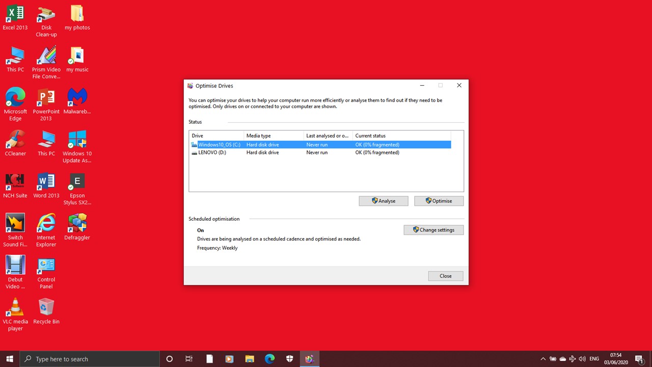

    My second post on this problem ! It was a week ago when I downloaded the Windows 10 May update and encountered a defragging problem. I think after you have done a big update the Defragmenter/Optimiser shows "Never run" until you actually run it. The problem is after running the Defragmenter on my drives it returns to "Never run" after a few minutes as per the print screen ! I have tried various things including Scannow so any ideas would be welcome !
    Brian

    It is possible that Disk Defragmenter service has been disabled or not properly running on your PC, causing defragmentation issues. To troubleshoot this, kindly try these following methods:
    Run System File Checker
    System File Checker is a utility in Windows that allows users to scan for corruptions in Windows system files and restore corrupted files. To do so, follow these steps:
    • Right-click the Start Menu and select Command Prompt (Admin).
    • Run this command: SFC /scannow
    • This may take several minutes to finish. If Command Prompt shows Verification 100% complete, close the command prompt and check if your issue has been fixed.
    Check Disk Defragmenter service
    Disk Defragmenter service is required to perform disk defragmentation. If Disk Defragmenter service and other services that is required to perform disk defragmentation is disabled, you may encounter issues doing defragmentation. To troubleshoot this, follow
    these steps:
    • In the search box, search and open Services.
    • Find Disk Defragmenter service, right-click it, and select Properties.
    • Make sure that Disk Defragmenter service Startup type is set to Manual.
    • Go back to the Services window and make sure that the Startup type of these services is set to Automatic:
      • Remote Procedure Call (RPC)
      • DCOM Server Process Launcher
      • RPC Endpoint Mapper
    Regarding your issue with the Windows Update, kindly answer these following questions for us to assist:
    • What is the update that you are trying to install (KB16XXXX)?
    • What are the specifications of your PC?
    • Do you receive any error messages when encountering a system crash?
    We'll be looking forward for your response.
    Regards.

    We have a couple of workarounds for defragmentation issues, try the following:
    Method 1: Check your hard disk for errors in Windows 10.
    • Press Windows key+X.
    • Select Command Prompt (Admin).
    • In the window that opens enter chkdsk /f.
    Method 2:
    Run System File Checker (SFC)
    Method 3: Check if Disk Defragmenter service is running properly.
    This service is required for performing disk defragmentation, and if it’s disable, you won’t be able to run a defragmentation tool.
    • Search for services.msc.
    • Make sure that Disk Defragmenter service is set to
      manual
    • Also, make sure that following services are set to Automatic:
      Remote Procedure Call (RPC).
      DCOM Server Process Launcher.
      RPC Endpoint Mapper.
    Let us know how it goes.
