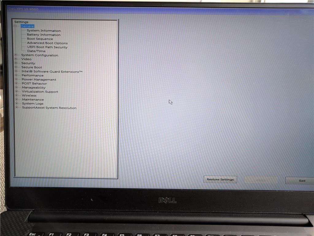

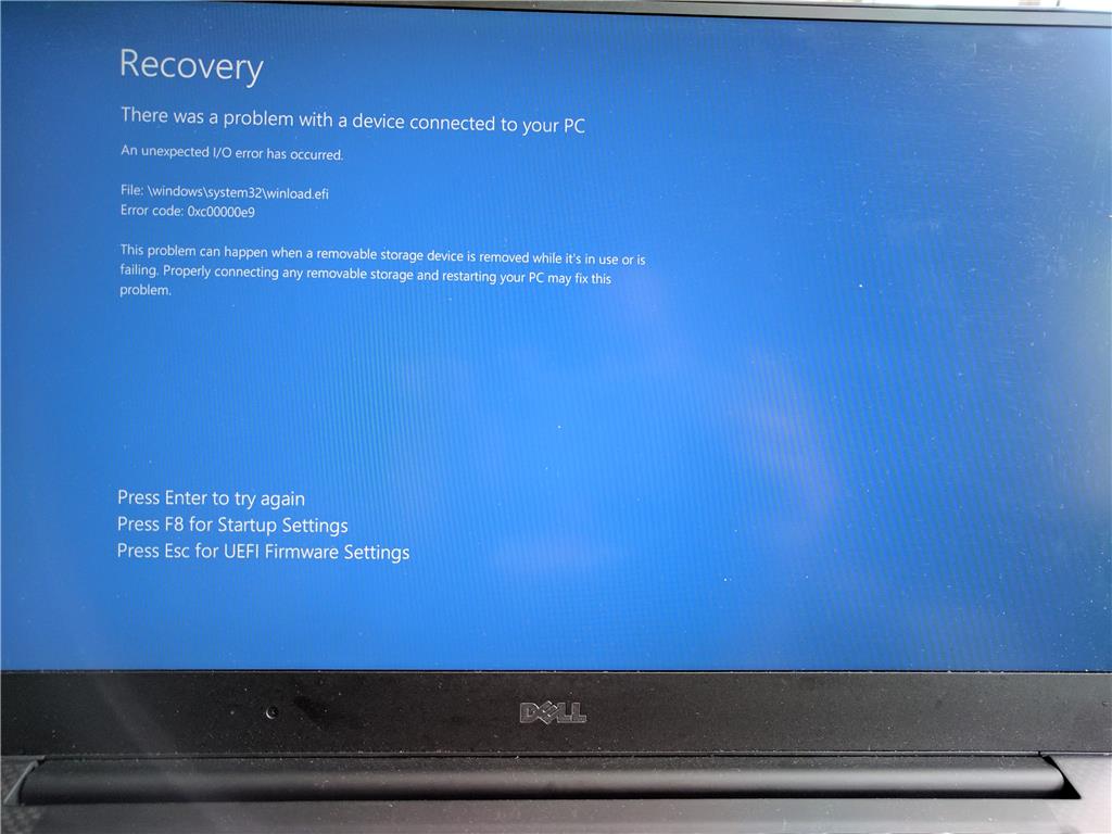

  3. BSOD on startup with code 0xc00000e9 with Dell XPS 15 9560
    Hi all,
    when starting up my new Dell XPS 9560 I randomly get a BSOD with error code 0xc00000e9. I then proceed to press Esc for the UEFI settings, change nothing, and I am able to start up normally. I have no external device connected to my laptop. How can I make
    this go away? Thanks.
