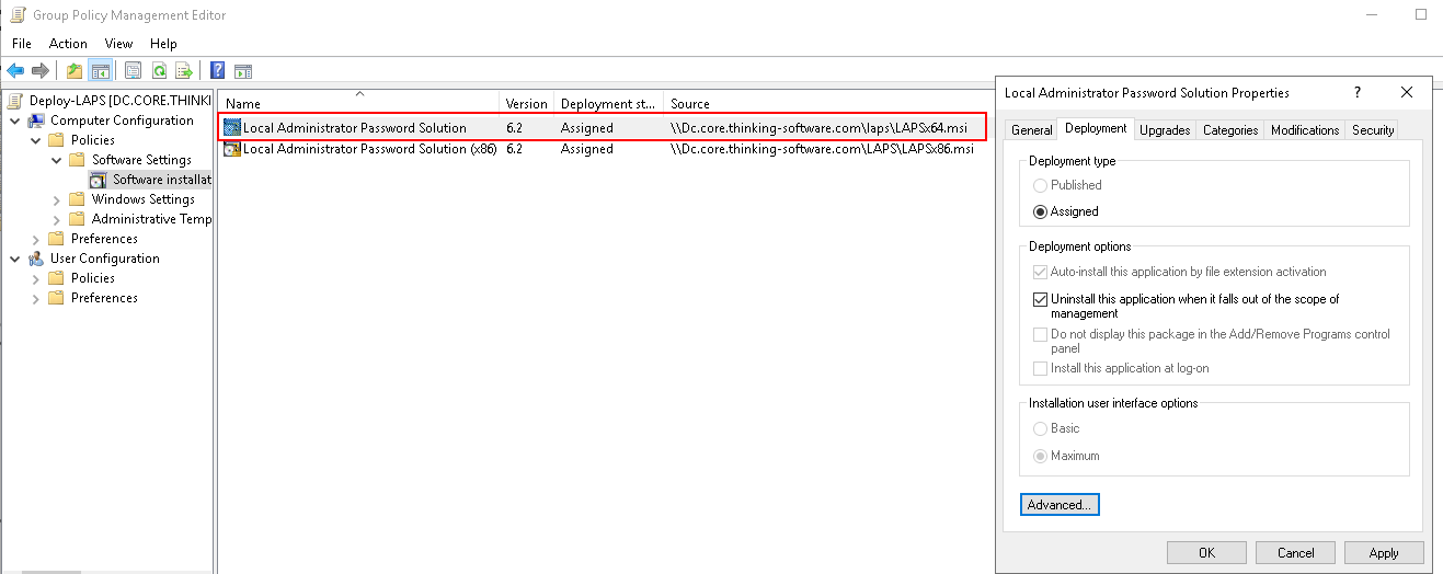

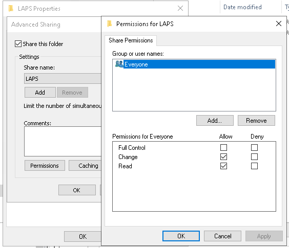

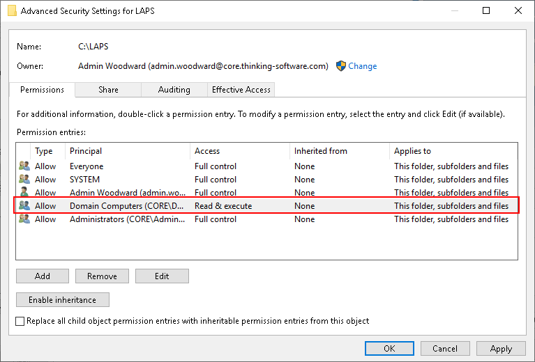

    I have created GPO which deploys LAPS to the local domain PCs. I am using a network share on the domain controller to host the .MSI
    'I believe' I have set everything up correctly:
    Deployed software via Group Policy won't install PC requires a restart 8ee21911-ab75-415f-8256-fd22d398c49c?upload=true.png
    Deployed software via Group Policy won't install PC requires a restart 935a417a-c04d-45d5-a74b-7eae9046dfbf?upload=true.png
    Deployed software via Group Policy won't install PC requires a restart a35904fe-dba8-4f38-89bd-2a73fa780c91?upload=true.png
    Deployed software via Group Policy won't install PC requires a restart a951ef6d-3e7d-4f1e-9b57-125221da5865?upload=true.png

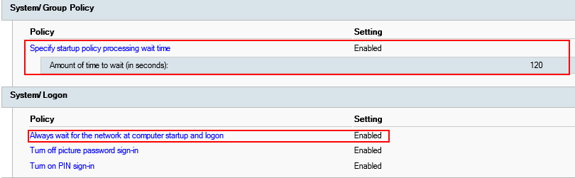

    ^ I have tried 30, 60 90 and 120 seconds and nothing helps. ^

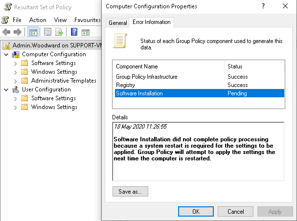

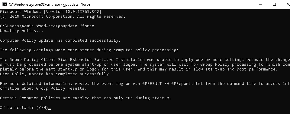

    but, every time I go onto the PC and do GPUPDATE /FORCE the above message shows. I then say "Y" so it reboots — which it does. After it reboots, I go into APPWIZ.CPL and LAPS isn't installed. If I run GPUPDATE /FORCE again the same message is shown in CMD? It's just a constant loop?!
    It isn't a compatibility or version issue because I can install it manually by going to the network share and also using msiexec /I “\\DC.CORE.THINKING-SOFTWARE.COM\LAPS\LAPSx64.msi” /quiet. I ran CMD and Administrator.
    I've even temporarily disabled UAC even though I know it wouldn't help the issue.
    I've gone through everything and it should be deployed, but it isn't.
    Any suggestions are appreciated.

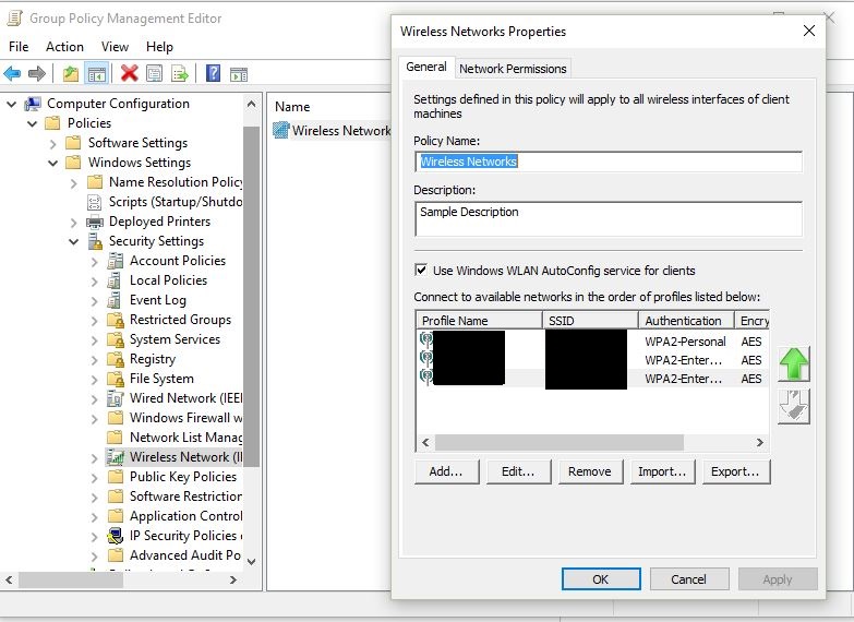

    In our organization we have three wireless networks that we deploy to all PCs using Group Policy. This allows users to automatically connect to the wireless networks with pass-through Windows credentials. The SSIDs of the wireless networks are hidden for
    security purposes.

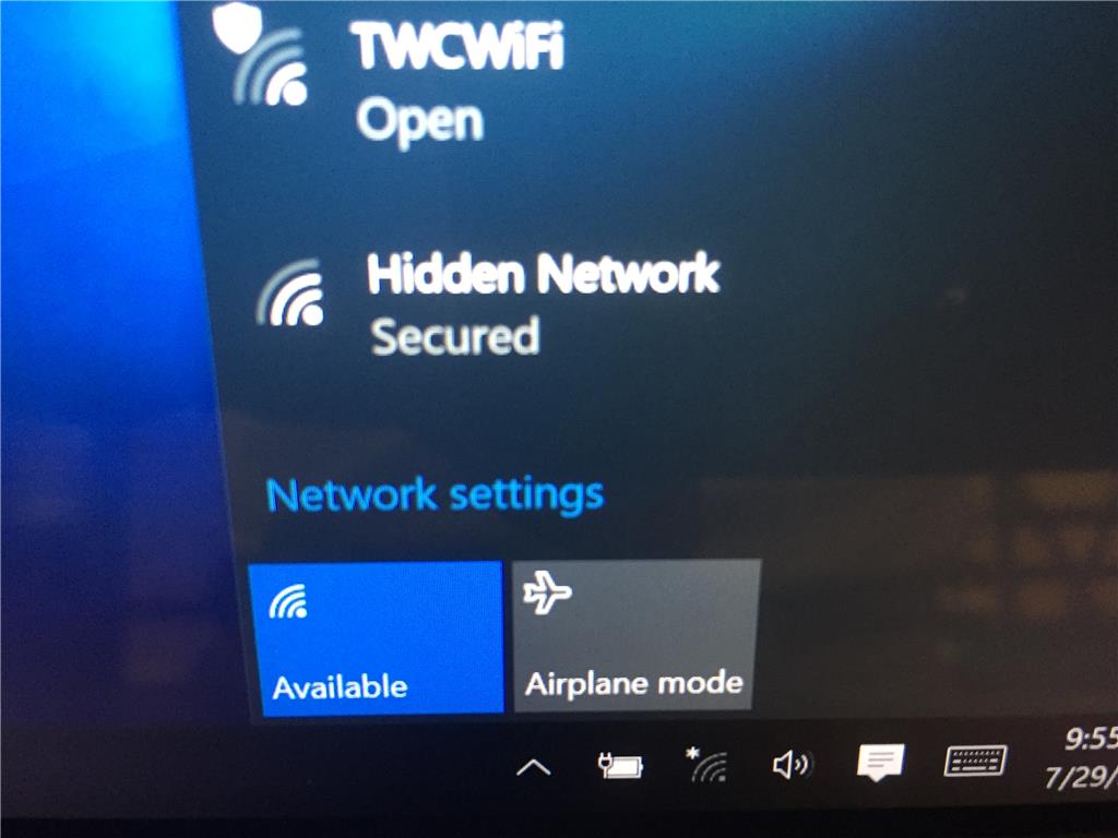

    Randomly, the networks will quit being recognized by the computer, and it will no longer automatically connect. For the users to connect, they must scroll to the bottom of their wireless networks listed and click on "Hidden Network." They are then prompted
    for the SSID of the network and then asked for their Windows credentials.
    Deployed software via Group Policy won't install PC requires a restart b849304d-b0f8-451a-85ce-d9ab5e5c9418.jpg
    The only solution we have found for this is to either delete the Windows user profile on the PC, or remove the network from Group Policy (which removes it from all PCs in the organization), then delete the network from the PC and add it back to Group Policy.
    Neither one of these is a good solution.
    We cannot delete the network using netsh because we get a message saying the network is deployed with Group Policy and is read only. I've also tried deleting the network from the registry key: HKEY_LOCAL_MACHINE\SOFTWARE\Microsoft\WlanSvc\GroupPolicy\Profiles.
    However, this seems to have no effect.
    Is there any way to deal with this wireless network profile corruption other than the two poor solutions I have found?
