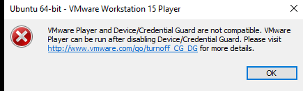

    I am unable to launch any Virtual Machines using VmWare Workstation Player on Windows 10 1809 x64 on a Dell Latitude 7490 laptop. I receive the following error.
    Device/Credential Guard are not Compatible - Virtualization pastedImage_0.png
    I have tried every solution I saw online with no success. After taking all the steps described below I tried updating to Windows 10 1903, tried all the same steps and still had no luck. I also tried VirtualBox where I didn't get any errors Virtual Machines would not launch, the screen just stayed black. I am out of ideas and looking for assistance.

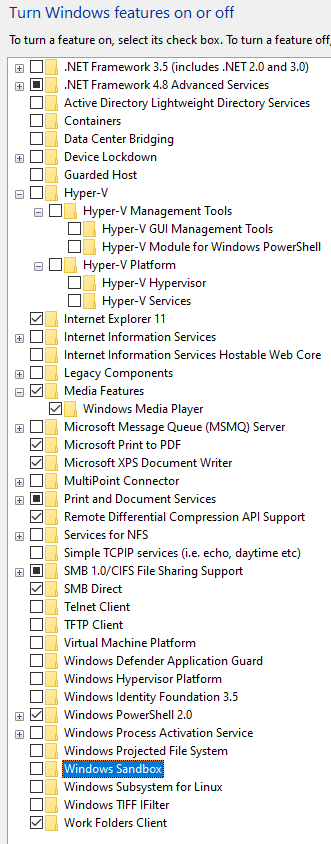

    I do not use hyper-v

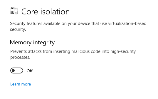

    Core Isolation / Memory protection was already turned off
    Device/Credential Guard are not Compatible - Virtualization pastedImage_3.png

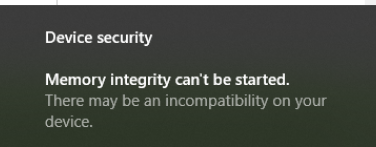

    I tried turning Core Isolation / Memory Protection on so that I could turn it off but I wasn't even able to turn it on.

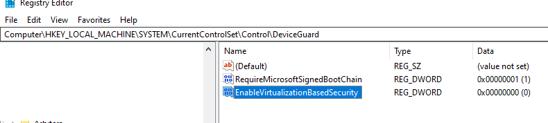

    Group Policy - I own and manage my computer. There is no group policy on this pc.
    Manage Windows Defender Credential Guard (Windows 10) | Microsoft Docs
    Device/Credential Guard are not Compatible - Virtualization pastedImage_6.png

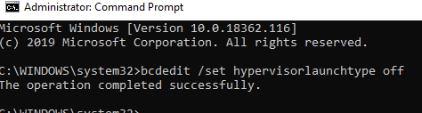

    bcdedit /set hypervisorlaunchtype off - This didnt work
    Device/Credential Guard are not Compatible - Virtualization pastedImage_7.png

    Whenever I try to run a vm in vmware,it gives this error:
    VMware Workstation and Device/Credential Guard are not compatible. VMware Workstation can be run after disabling Device/Credential Guard.
