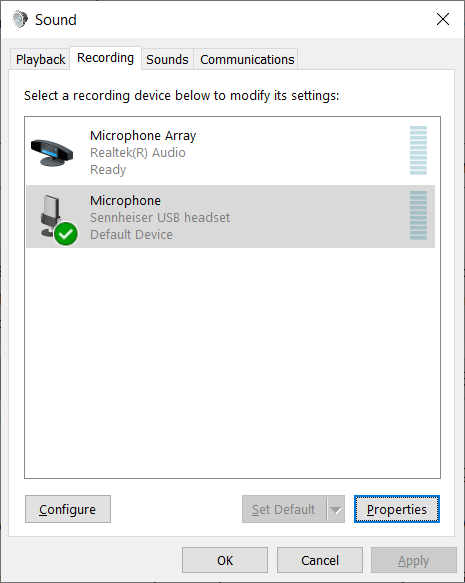

    I have a Lenovo T480 Windows 10 laptop which recently got upgraded from version 1809 to 1909 build 18363.720:. I had a Sennheiser PC 7 USB headset:
    https://www.eposaudio.com/en/de/gaming/products/pc-7-usb-voice-over-ip-headset-504196
    The headset used to work perfectly before but after the upgrade, the microphone stopped working. When I go to Control Panel => Sound, the microphone appears to be ready for use:

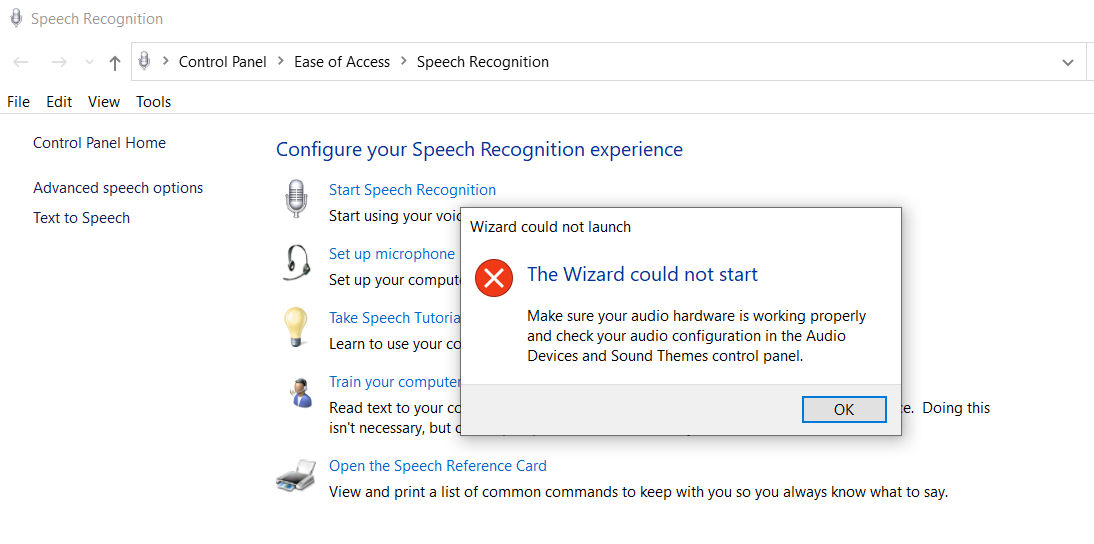

    If I go to Configure => Set up Microphone, I get this error message:
    Device driver in Windows 10 Feature Update 1909 breaks USB headset microphone ecc4e885-d534-4f23-9671-012b745255f9?upload=true.png ​

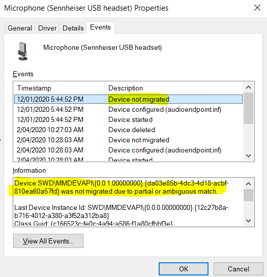

    When I look at the Device Manager => Device => Events tab, I see "Device not migrated" error events:
    Device driver in Windows 10 Feature Update 1909 breaks USB headset microphone bc5d5cd6-8edd-4a86-a6ff-f639af6f5a1a?upload=true.png ​
    This is the text from the Information field:
    Device SWD\MMDEVAPI\{0.0.1.00000000}.{da03e85b-4dc3-4d18-acbf-810ea60a57fd} was not migrated due to partial or ambiguous match.
    Last Device Instance Id: SWD\MMDEVAPI\{0.0.0.00000000}.{12c27b8a-b716-4012-a380-a3f52a312ba8}
    Class Guid: {c166523c-fe0c-4a94-a586-f1a80cfbbf3e}
    Location Path:
    Migration Rank: 0xF00000000000F120
    Present: false
    Status: 0xC0000719
    I have tried repeatedly to uninstall the device, reboot the system and reattach the headset but the same error message appears and the microphone does not work. The headphones work well.

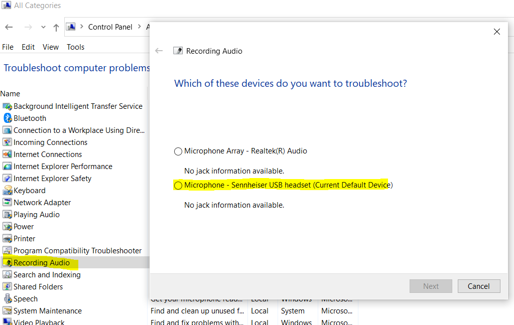

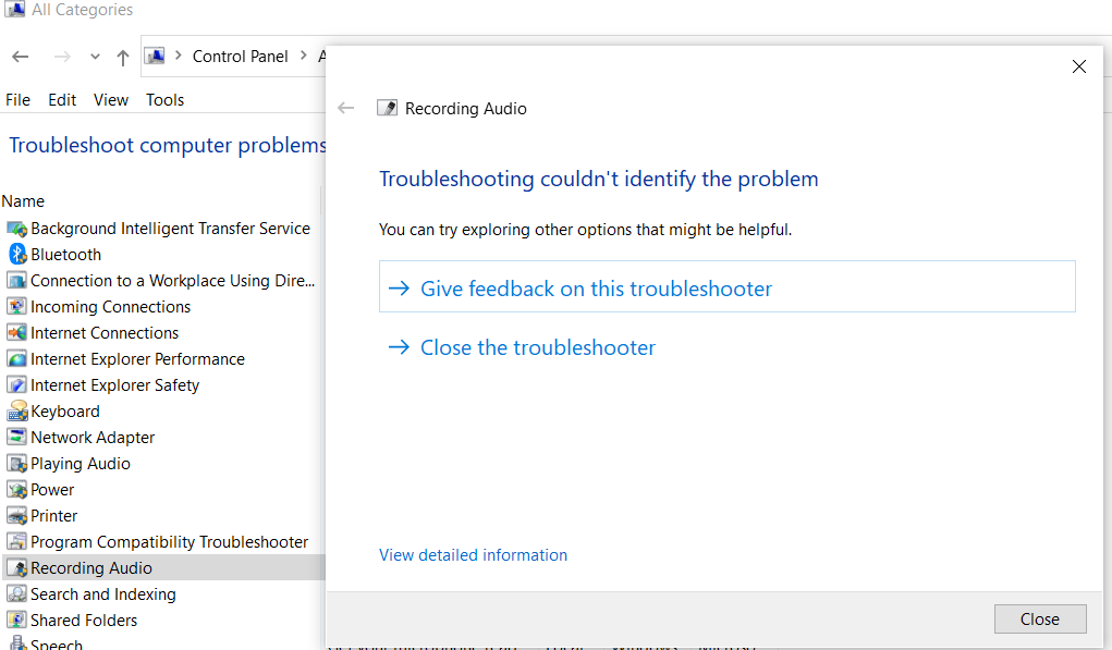

    I have tried running the Recording Audio troubleshooter but it does not find any issues with the device:
    Device driver in Windows 10 Feature Update 1909 breaks USB headset microphone 43f74cb1-0509-41b5-b4ac-407fc821edef?upload=true.png ​
    Results:
    Device driver in Windows 10 Feature Update 1909 breaks USB headset microphone 3dbdd84a-3425-48e6-bcd7-3ed6ed1d48a1?upload=true.png ​

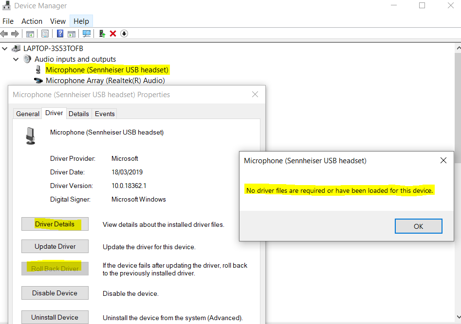

    The problem with trying to rolling back the driver for the Sennheiser headset is that it does not use the vendor supplied driver but rather a Windows built in driver:
    Device driver in Windows 10 Feature Update 1909 breaks USB headset microphone 56c7b594-ac11-4cc8-81cf-8749632f720e?upload=true.png ​
    As can be seen, the "Roll Back Driver" option is also grayed out.
    As the computer had Feature Update 1909 running for more than 10 days, I could not restore version 1809 to confirm if that would restore the microphone functionality. Reinstalling/resetting Windows would probably solve the issue but a I do not want to reinstall all my programs again and b when Windows Update upgrades again to 1909 the problem will probably resurface.

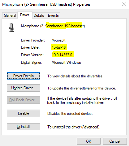

    I was successfully able to use the microphone in a somewhat older computer running Windows 10 version 1607. On this computer, I notice that it uses an older Microsoft driver, version 10.0.14393.0 published on 15 Jul 16:
    Device driver in Windows 10 Feature Update 1909 breaks USB headset microphone a5eba3d3-24db-40dd-9620-05c4a6296330?upload=true.png ​
    The driver in use on the newer computer is 10.0.18362.1, as seen in previous screenshot. I tried copying over the Microsoft driver files from the old computer to the new one, and forcing Windows to update to use the older driver file. However this still does not resolve the problem.
