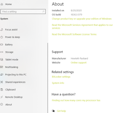

    Product: HP Pavilion Notebook M2W70PA#AC
    Operating System: Microsoft Windows 10 64-Bit
    As stated in Subject, cannot see Device Encryption Option in about section of Settings
    - OS : Window 10 Home Single language

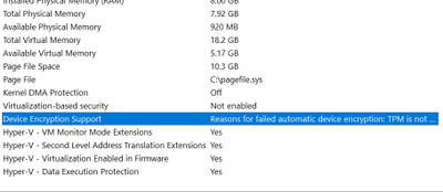

    -Checked for Device Encryption Support in System Information and its corresponding field show : Reason for automatic device encryption, TPM is not usable PCR7 binding is not supported, hardware security test interface failed and device is not mordern is not mordern standby.....
    - Verified HP suport assistance and could not see any driver or bios update pending
    - Also, in about section, could see option bitlocker setting which takes me to window store and it shows as blank page
    Kindly assist to enable Device Encryption to safeguard data if laptop is stolen Device Encryption Not Found in About Section of Settings f300642d-456d-4d19-9660-73039e063bc2?upload=true.png Device Encryption Not Found in About Section of Settings dbc7a3c2-b082-4627-aaf4-34030dc8ad24?upload=true.png
    VinitMandlesha, Mar 6, 2021
