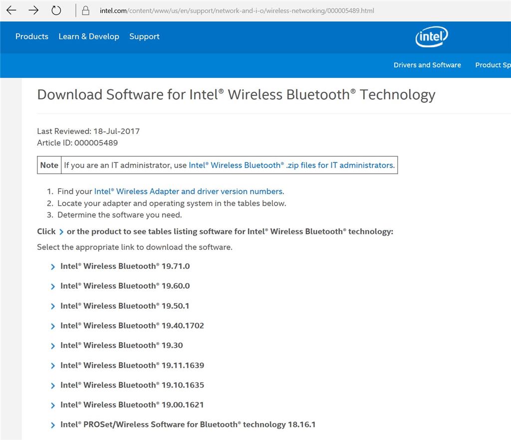

  3. Device manager keeps refreshing
    Thanks. I uninstalled the driver then installed the top driver on this list. Assumed it was the latest.
    Now the device manager refreshes again with the yellow exclamation mark appearing and disappearing in between refreshes.
    Device manager keeps refreshing! (I found the cause) 8687e325-d026-4abd-8094-edcd33f0eebe.jpg
    Paul740329, Jul 21, 2019
