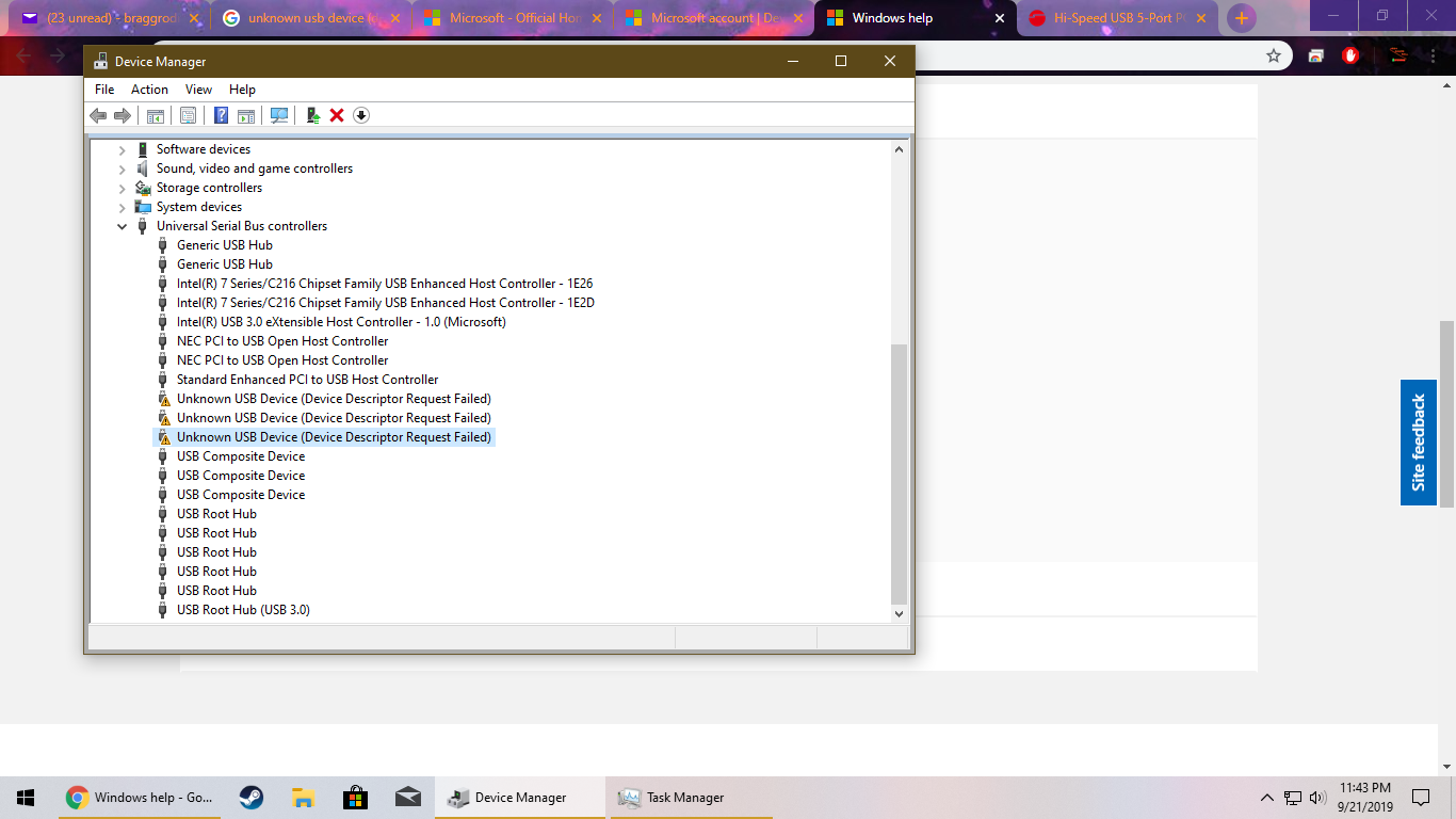

    Ive recently noticed a problem with my computer and being unable to update via windows update (getting error 0x80080005) and i searched everywhere to see how to fix this. I even called Microsoft so they could try to help me but they also couldn't figure it out. My computer is built of parts i added over the years so it could have been a hardware problem. And it was. I bought a new USB PCIe card to add more ports to my computer (https://www.siig.com/products/it-products/usb/adapters/pci/hi-speed-usb-5-port-pci.html This one to be exact) because my original USB ports went out. I have an Asrockz77 pro4 motherboard. I found out that when i go to device manager there are three devices with an error on them "Unknown USB device (device descriptor request failed)" When i open the services application i noticed Windows Updater was stuck on "starting". The only way to fix this was to uninstall the device in device manager that came with the extra card i purchased (which automatically made the error device vanish without me touching them) then hit scan for hardware changes. When it finally recognized my USB devices windows update was finally able to go from "starting" to "running" and everything goes back to normal. My question is, is there a way to get around the windows update waiting to get a device description or is it time for a new upgrade entirely? Device manager/Windows Update 87aa9e60-4b74-4548-af8d-1716c9381c73?upload=true.png
