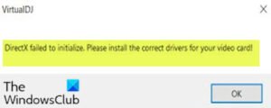

Discus and support DirectX failed to initialize error on Windows 10 in Windows 10 News to solve the problem; [ATTACH]Some PC users after installing the Virtual DJ or any such software on their […] This article DirectX failed to initialize error on Windows 10... Discussion in 'Windows 10 News' started by WinClub, Jan 14, 2021.

    Hi, i've tried the following.
    Method 1: I'm running Window's 10. I cannot seem to find a "display" tab. I've found "display settings." From there I don't see any option for "Advanced settings" or "troubleshoot" tab. Any guidance on how to find it on Window's 10 would be appreciated.
    Method 2: All controllers are working. The game, Civilization will not even fire up before I get the "DirectX initialization Error.
    Method 3: The diagnostic tool Dxdiag does not list a error and the window's system is reporting Direct X: version 12 is working.
    Thank you for reply before. I'll try anything that can be suggested.

    I appreciate you for providing details about the issue and we are glad to assist you.
    Try the following steps and check if it helps:
    Step 1:
    I suggest you to check the DirectX Version installed on your system.
    Follow the below steps to check the DirectX Version:
    • Press Windows key + R from the Desktop.
    • Type dxdiag and hit Enter.
    • Check the DirectX Version.
    Step 2:
    I suggest you to update the Graphic driver from the Device Manager and check if it works.
    Follow the below steps:
    • Press Windows + R on the Keyboard.
    • Type in devmgmt.msc and hit Enter.
    • Select Graphic driver from the list.
    • Right click on the Graphic driver and click on Update driver Software.
    If the issue persists then install the latest graphic driver from the manufacturer and check if it helps.
    Kindly let us know if you need any further assistance with Windows. We are glad to assist you.
    Harshavardhan Rathod, Jan 14, 2021
  4. DirectX failed to initialize error on Windows 10
    DirectX installation failed
    Thank you for the update. Please verify if DirectX June 2010 is being offered via Windows Update. If your computer is already running DirectX 12, it has backwards compatibility with the previous version of DirectX. Moreover, you may also want to consider
    performing the suggested steps in this article.
    Regards.
    Melchizedek Qui, Jan 14, 2021
