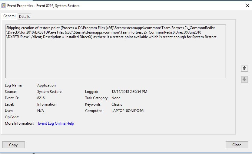

    I am trying to play Team Fortess 2 on my new laptop. However the games keeps crashing as soon as it starts . I checked Windows Event logs and found the following error :
    DirectX Setup Keeps throwing error, preventing me to play a game c810d061-b10d-43af-9495-fd83e394976f?upload=true.png

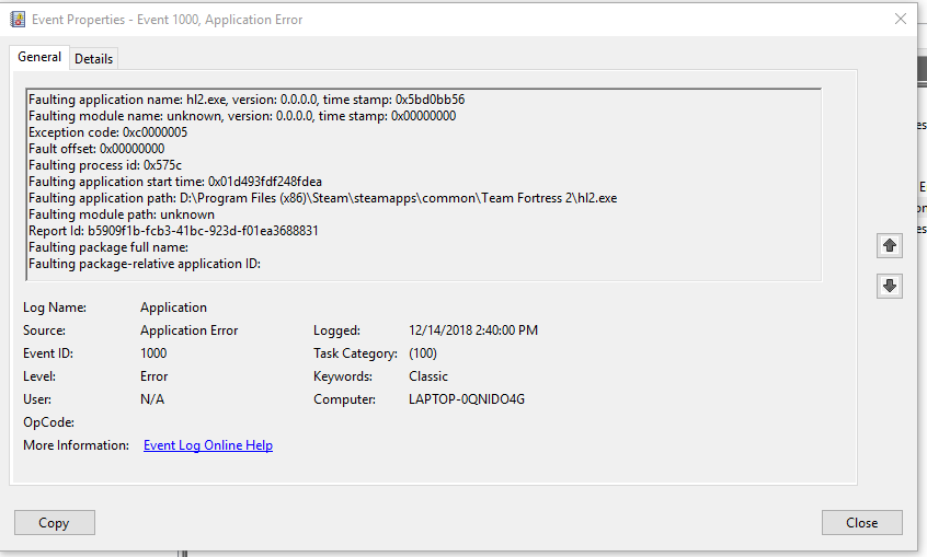

    While the above error was not very helpful , because it did not provide me a faulting module name , however just before the above error in Evntvwr , i saw the following entry :
    DirectX Setup Keeps throwing error, preventing me to play a game aa82d412-5e8a-4f31-8f42-adf74db64a53?upload=true.png

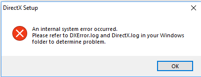

    This made me think that the error could be related to DirectX , as the game does try to do a DirectX setup when I launch it and then crashes. So I ran the DXSETUP.exe mentioned in the above path as administrator. And sure enough, DirectX setup fails with the following error :
    DirectX Setup Keeps throwing error, preventing me to play a game 6111f7fb-10be-4639-a10d-18f5d9edf4d2?upload=true.png

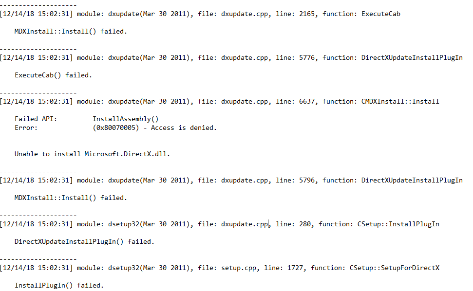

    In checking the DXError.log & DirectX.log under C:\Windows\logs I see the following errors
    DXError.log:
    DirectX Setup Keeps throwing error, preventing me to play a game af4800a7-ef3a-4daa-ba06-5c87c1281f8b?upload=true.png
    I am perplexed by the access denied error because I am already running the setup as Administrator. And I have already run
    Deployment Image Servicing and Management (DISM) too ( DISM.exe /Online /Cleanup-image /Restorehealth ) AND
    sfc /scannow
    Both of them did not show any errors or apparent problems.
