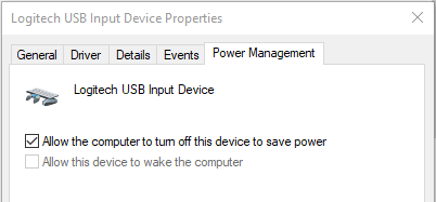

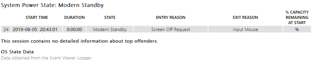

    I have new laptop Dell which support modern standby. There is one thing, I can't disable mouse to prevent waking up from modern standby. My mouse does not have power switch, so every time when I put my laptop to backpack it wakes up, because of mouse.
    I have tried disable it in device manager, but it is already disabled
    Disable mouse wake up in modern standby 8f95cb42-db62-48a3-9d7d-6010d1552847?upload=true.png
    So I have tried this in elevated command line, but it does not work too:
    powercfg /devicedisablewake "Logitech USB Input Device"
    You do not have permission to enable or disable device wake.
    How I can properly disable wake event from input mouse ?

    Windows 10 -- Cannot disable the mouse from waking computer from sleep
    I suggest you to follow the methods below and check if it helps:
    Method 1
    Follow the steps below to try to disable device to wake the computer:
    • Press Windows key + X.
    • Click on Command Prompt (Admin).
    • Type powercfg –devicedisablewake and press
      Enter.
    • Restart the computer and check if issue persists.
    Method 2: Disable the Wake timers
    Follow the steps below to Disable the Wake timers:
    • Press Windows key +X.
    • Click on Power Options.
    • Click on edit Plan Settings and click on
      Change advanced power settings.
    • Expand Sleep option and “Allow wake timers" and set this to
      disable.
    Giridhar J, Aug 6, 2019
