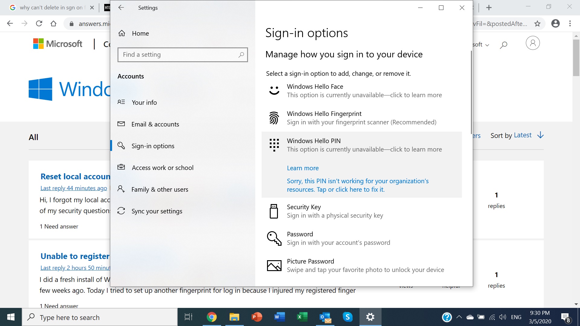

    I've tried to read other postings on disabling PIN from Windows 10. However at the Windows Hello Pin, it doesn't show the button for removing or disabling as below screen shot. Can anyone advice as I just want the PC to start automatically
    Disable PIN from Windows 10 1fcc5197-2074-4573-b5c3-00a0a7bfc972?upload=true.jpg

    You can also disable PIN using registry. Try these steps:
    1. Open Registry Editor.
    2. Go to HKEY_LOCAL_MACHINE\SOFTWARE\Policies\Microsoft\Windows\System.
    3. Set AllowDomainPINLogon to 0.
    4. Close Registry Editor and reboot your system.
    Hope this helps!

    In order to disable the PIN sign in option in Windows 10, refer to the below steps.
    Step 1: Access PC settings and open
    Users and accounts
    Step 2: Select Sign-in options and tap the
    Remove
    button under PIN.
    Note: you can navigate to the same path in order to re-enable the PIN.
    Hope the above information is helpful. If you need further assistance, we would be happy to help you.

    Hi I'm Peter an independent advisor, if you want to disable Windows 10 PIN sign in option, you can do it in this way.
    Step 1: Press Windows and R key on the keyboard and enter gpedit.msc on Run open box. Then, press Enter or click the OK button to access Local Group Policy Editor.
    run gpedit.msc
    Step 2: In this interface, access Computer Configuration > Administrative Templates > Systems > Logon > Turn on PIN sign-in.
    turn on PIN sign in option
    Step 3: Double click Turn on PIN sign-in, and set this option to Disabled. Then click OK and Apply button. After that, the PIN sign in option is disabled.
    PeterFlynn4, May 3, 2020
