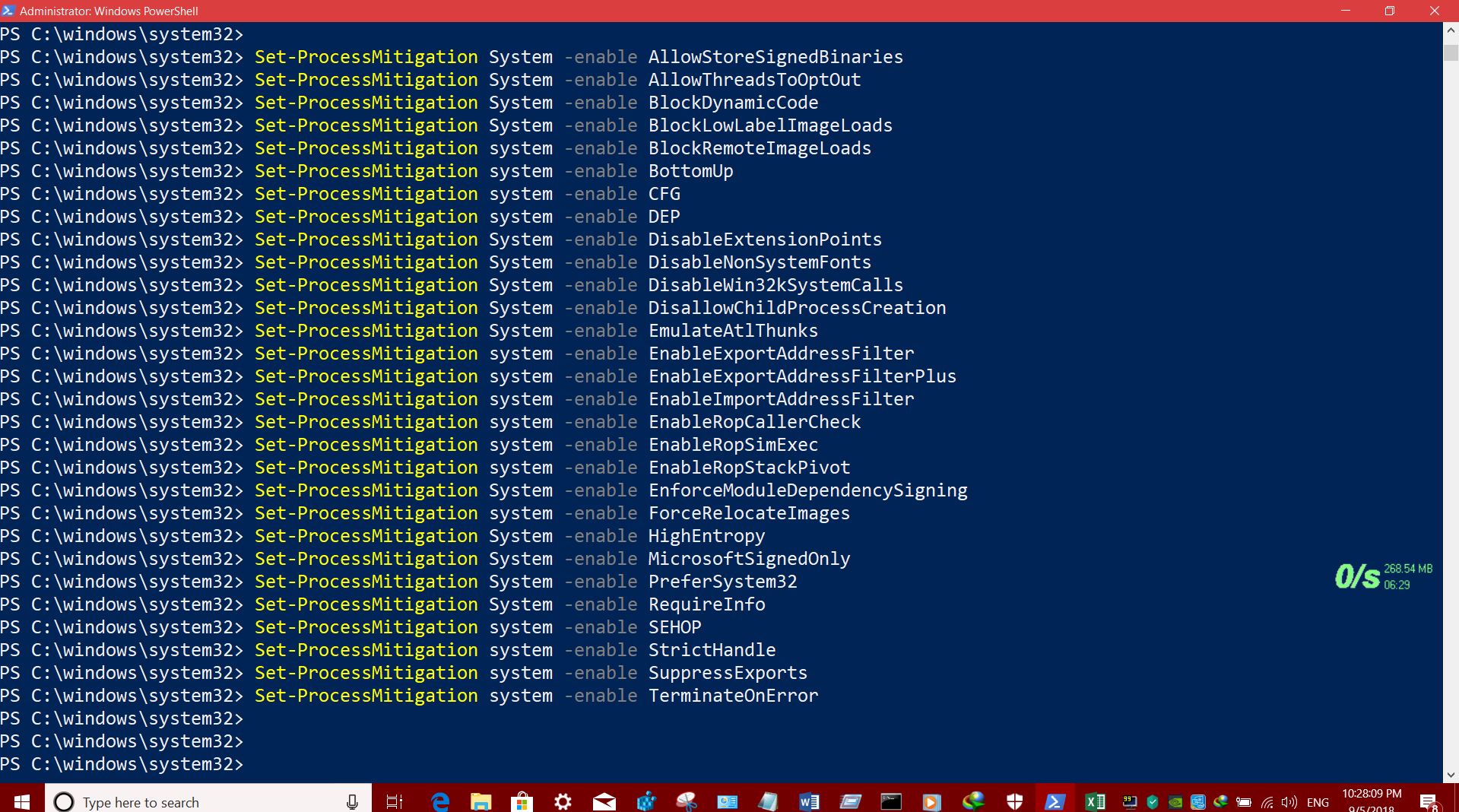

    WINDOWS DEFENDER EXPLOIT PROTECTION POWERSHELL SCRIPTS TO ENABLE OR DISABLE PROCESS MIGITATION COMPONENTS
    I am sharing some PowerShell scripts to enable migration process components at system level
    Just open WINDOWS POWERSHELL run as administrator and enter the following commands to enable
    Set-ProcessMitigation System -enable AllowStoreSignedBinaries
    Set-ProcessMitigation System -enable AllowThreadsToOptOut
    Set-ProcessMitigation System -enable BlockDynamicCode
    Set-ProcessMitigation System -enable BlockLowLabelImageLoads
    Set-ProcessMitigation system -enable BlockRemoteImageLoads
    Set-ProcessMitigation system -enable BottomUp
    Set-ProcessMitigation system -enable CFG
    Set-ProcessMitigation system -enable DEP
    Set-ProcessMitigation System -enable DisableExtensionPoints
    Set-ProcessMitigation System -enable DisableNonSystemFonts
    Set-ProcessMitigation System -enable DisableWin32kSystemCalls
    Set-ProcessMitigation System -enable DisallowChildProcessCreation
    Set-ProcessMitigation System -enable EmulateAtlThunks
    Set-ProcessMitigation system -enable EnableExportAddressFilter
    Set-ProcessMitigation system -enable EnableExportAddressFilterPlus
    Set-ProcessMitigation system -enable EnableImportAddressFilter
    Set-ProcessMitigation system -enable EnableRopCallerCheck
    Set-ProcessMitigation system -enable EnableRopSimExec
    Set-ProcessMitigation system -enable EnableRopStackPivot
    Set-ProcessMitigation System -enable EnforceModuleDependencySigning
    Set-ProcessMitigation system -enable ForceRelocateImages
    Set-ProcessMitigation System -enable HighEntropy
    Set-ProcessMitigation System -enable MicrosoftSignedOnly
    Set-ProcessMitigation System -enable PreferSystem32
    Set-ProcessMitigation System -enable RequireInfo
    Set-ProcessMitigation system -enable SEHOP
    Set-ProcessMitigation system -enable StrictHandle
    Set-ProcessMitigation system -enable SuppressExports
    Set-ProcessMitigation system -enable TerminateOnError

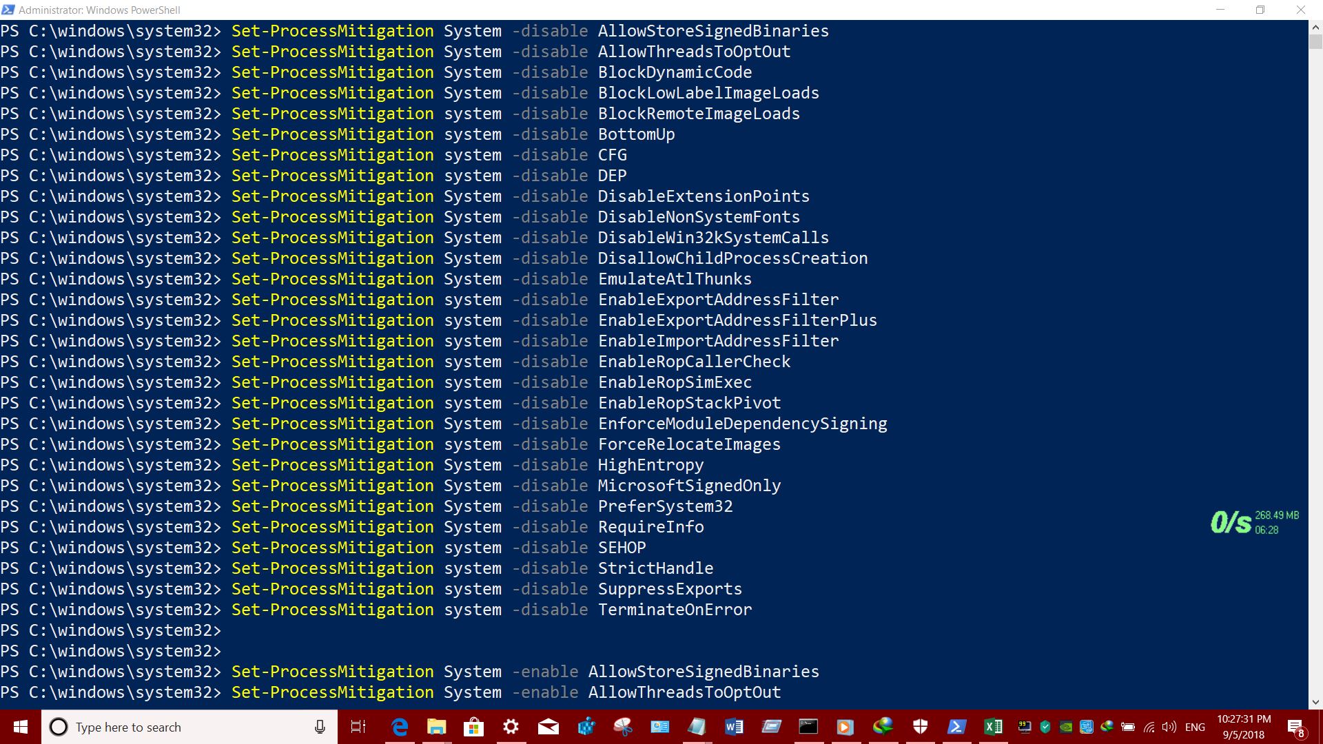

    to Disable migration process components at system level
    Just open WINDOWS POWERSHELL run as administrator and enter the following commands to Disable
    Set-ProcessMitigation System -disable AllowStoreSignedBinaries
    Set-ProcessMitigation System -disable AllowThreadsToOptOut
    Set-ProcessMitigation System -disable BlockDynamicCode
    Set-ProcessMitigation System -disable BlockLowLabelImageLoads
    Set-ProcessMitigation system -disable BlockRemoteImageLoads
    Set-ProcessMitigation system -disable BottomUp
    Set-ProcessMitigation system -disable CFG
    Set-ProcessMitigation system -disable DEP
    Set-ProcessMitigation System -disable DisableExtensionPoints
    Set-ProcessMitigation System -disable DisableNonSystemFonts
    Set-ProcessMitigation System -disable DisableWin32kSystemCalls
    Set-ProcessMitigation System -disable DisallowChildProcessCreation
    Set-ProcessMitigation System -disable EmulateAtlThunks
    Set-ProcessMitigation system -disable EnableExportAddressFilter
    Set-ProcessMitigation system -disable EnableExportAddressFilterPlus
    Set-ProcessMitigation system -disable EnableImportAddressFilter
    Set-ProcessMitigation system -disable EnableRopCallerCheck
    Set-ProcessMitigation system -disable EnableRopSimExec
    Set-ProcessMitigation system -disable EnableRopStackPivot
    Set-ProcessMitigation System -disable EnforceModuleDependencySigning
    Set-ProcessMitigation system -disable ForceRelocateImages
    Set-ProcessMitigation System -disable HighEntropy
    Set-ProcessMitigation System -disable MicrosoftSignedOnly
    Set-ProcessMitigation System -disable PreferSystem32
    Set-ProcessMitigation System -disable RequireInfo
    Set-ProcessMitigation system -disable SEHOP
    Set-ProcessMitigation system -disable StrictHandle
    Set-ProcessMitigation system -disable SuppressExports
    Set-ProcessMitigation system -disable TerminateOnError
    above commands are used to Disable protection at system level
    for more information visit below micosoft website :
    https://docs.microsoft.com/en-us/wi...er-exploit-guard/customize-exploit-protection
    I am requesting moderators and engineers to review my article is it ok for windows 10 , PLEASE COMMENTS HERE
    I have enabled above process migitation components in my windows 10 laptop
