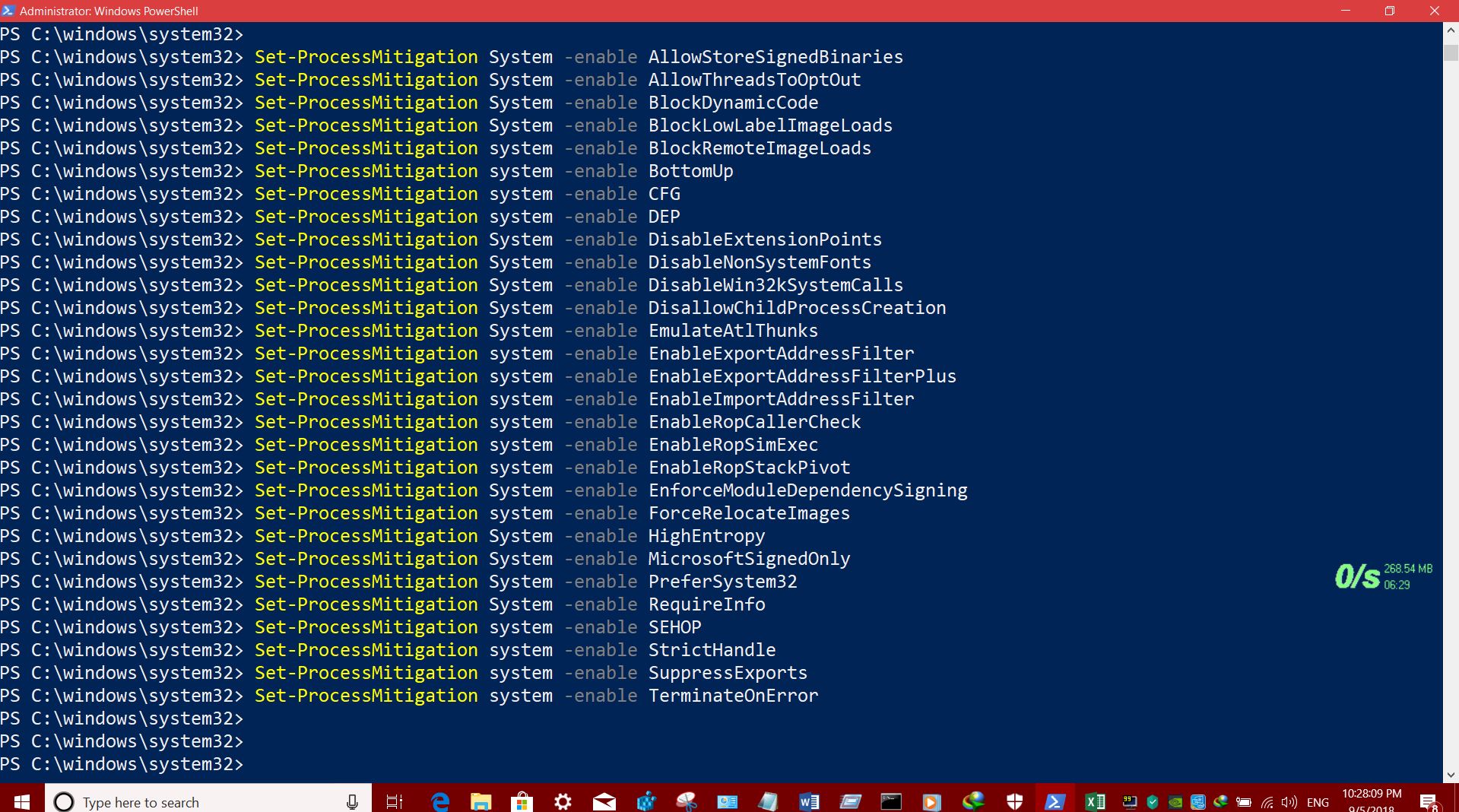

  3. RAJU.MSC Win User
    WINDOWS DEFENDER EXPLOIT PROTECTION POWERSHELL SCRIPTS TO ENABLE OR DISABLE PROCESS MIGITATION COMPONENTS
    I am sharing some PowerShell scripts to enable migration process components at system level
    Just open WINDOWS POWERSHELL run as administrator and enter the following commands to enable
    Set-ProcessMitigation System -enable AllowStoreSignedBinaries

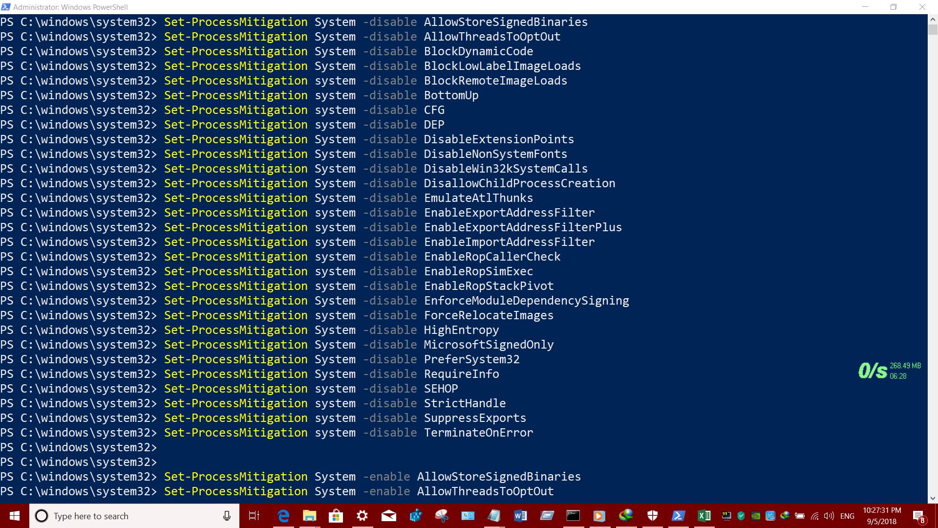

    to Disable migration process components at system level
    Just open WINDOWS POWERSHELL run as administrator and enter the following commands to Disable
    Set-ProcessMitigation System -disable AllowStoreSignedBinaries

    I am requesting moderators and engineers to review my article is it ok for windows 10 , PLEASE COMMENTS HERE
    I have enabled above process migitation components in my windows 10 laptop
    Disabled Exploit Protection System-wide but Process Explorer shows CFG and DEP enabled. ba3dcdcc-0978-4542-85ea-543bbee5c1bc?upload=true.jpg
    [table][tr][td] Disabled Exploit Protection System-wide but Process Explorer shows CFG and DEP enabled. 047e108b-7f0e-40c7-bde9-7defe44559ca?upload=true.jpg [/td][/tr][tr][td][/tr][tr][td][/tr][tr][td][/tr][tr][td][/tr][tr][td][/tr][tr][td][/tr][tr][td][/tr][tr][td][/tr][tr][td][/tr][tr][td][/tr][tr][td][/tr][tr][td][/tr][tr][td][/tr][/table]
    Moved from: Windows 10 / Security & privacy
    RAJU.MSC, Jan 14, 2022
