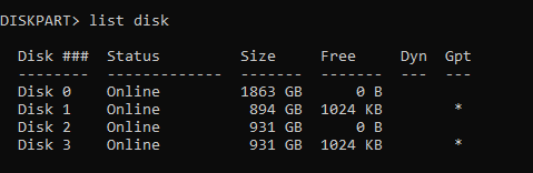

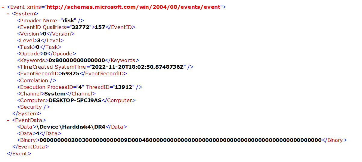

  2. Disk surprise removed. But it doesn't exist.
    So I'm playing train sim world 3 and it crashes with an access violation error. I check event viewer and there is an event id 157 a.k.a disk surprise removed. Specifically disk 4 surprise removed, but I only have disks numbered 0-3. No disk4 exists in this system, atleast not physically.
    disk 0 has been surprise removed after going out of sleep 7a59466e-864d-47c6-b647-3f8d9e1624ea?upload=true.png
    disk 0 has been surprise removed after going out of sleep 47dcdf31-fb04-4521-a667-33f7c13befa9?upload=true.png
    PekkaPalin, Jun 16, 2024

  4. disk 0 has been surprise removed after going out of sleep
    They are not totally full. It seems like that its a feature of DISKPART that it shows all disks as full. What do you mean in windows drives are listed differently? Task manager shows 0-3, disk manager shows 0-3. Only one that doesn't is explorer because it shows letters and not numbers.
