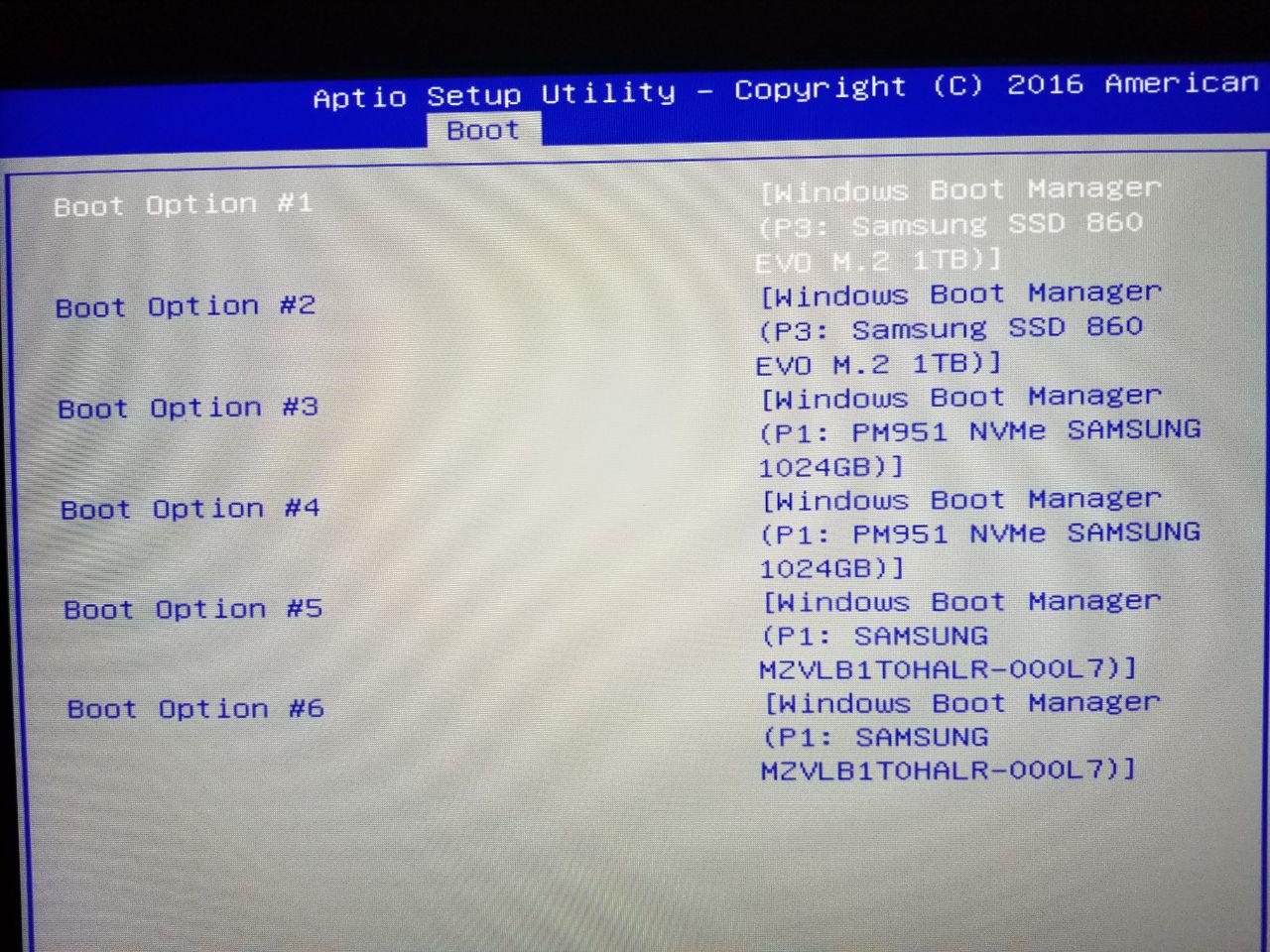

    My machine, MSI Titan GT80S SLI "Skylake" sometimes takes over a min to boot and sometimes just 30 seconds, weird. I wonder if the boot sequences as defined in UEFI has something to do with it.
    It does not look right. The first disk that appears there, 860 EVO, is not the primary boot disk. Neither is the second one, PM951. The one at the bottom (option 5 and 6) is PM981 that is the primary Win10 boot disk and that defined in the bcdedit.

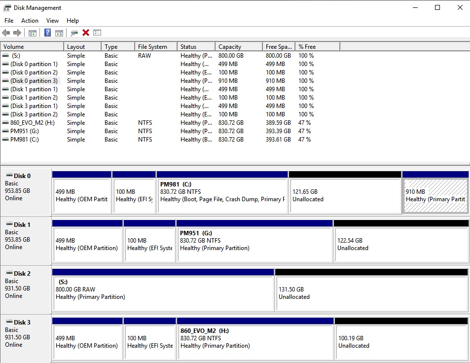

    This is how the it's seen in Disk Management. PM981 is the disk 0 or C:. That's the primary boot disk.
    Should it not show up in the UEFI as the first disk (option 1 and 2)?

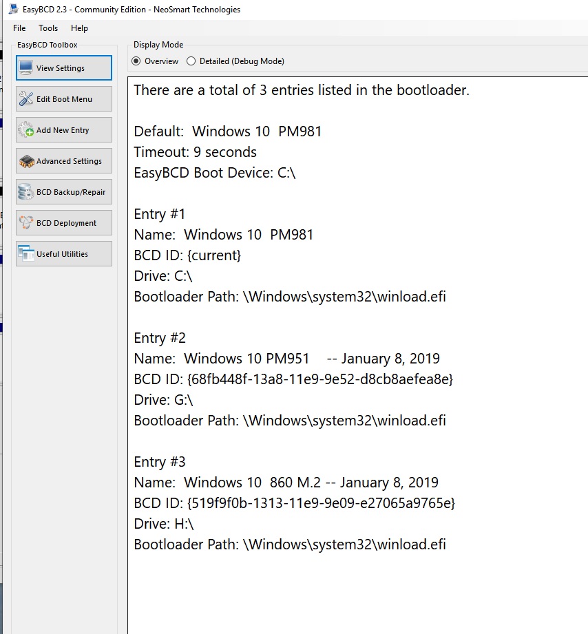

    This is how bcdedit looks (Via EasyBCD)

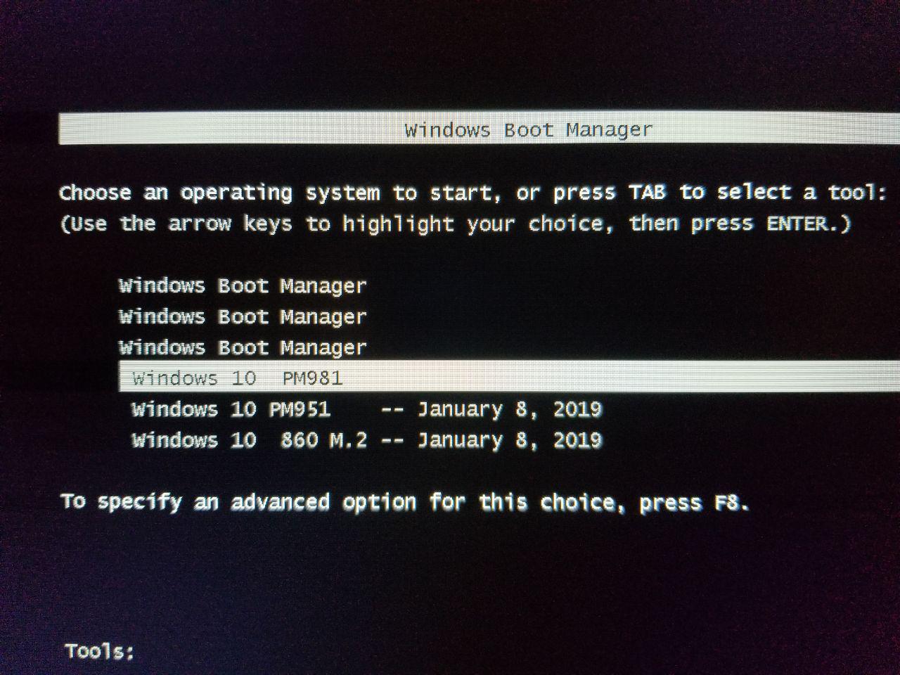

    And that is the actual boot menu resulting from bcdedit configuration. It is correct.
    There are 3 bootable disks in the system right now, the boot disk can be selected by scrolling up/down and hitting enter. All that works but that still raises the question why in UEFI the primary boot disk is not choice 1 which is the top, or default choice here. Could it be that the machine tries all the options until it gets to the correct one and that explains the slight timeout at times?
