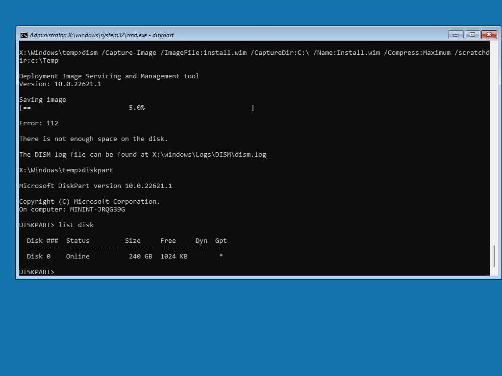

  3. Hyper-V | DISM Error 112 There is not enough space on the Disk
    Hello all,
    I've tried looking around the forum for resolving this issue but am coming up short.
    I have a Hyper-V Instance of Windows 11 Pro (Unactivated) that I've prepared and sysprepped for mass deployment.
    I load the winPE environment into the CD/DVD slot of the Hyper-V and boot into WinPE and run the following command
    dism /Capture-Image /ImageFile:install.wim /CaptureDir:C:\ /Name:Install.wim /Compress:Maximum
    Doing this yields a Error 112 code suggesting there is not enough space on the disk.
    What I've attempted:
    So what I have done is within the Hyper-V setting, turned OFF dynamic memory and assigned it 6144mb of memory. It has 4 virtual processors assigned to it and according to DISKPART, Disk 0 (the only disk on this!) is set at 240 GB. I also tried to modify the /scratchdir and pointed it to the C:\Temp folder to see if perhaps it had something to do with that.
    DISM /capture-ffu on Hyper-v. Getting error 112 not enough disk space when there is way... de66c007-cb83-4160-a81f-6240f2869ea7?upload=true.png
    Any help would be appreciated!
    Cristian Aviles-Morales, Jun 11, 2024
