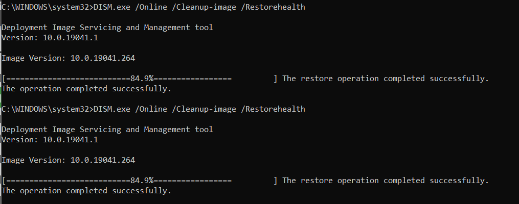

    DISM scan stops at 84.9%
    Today I opened cmd in administrator then typed "DISM.exe /Online /Cleanup-image /Restorehealth" to check any corrupt file or what ever it does. I saw it stops at 84.9%. I did it 3 times and the result is same. Why it doesn't completes till 100%? Is it bad for my PC? DISM scan stops at 84.9% eb0fb69a-25e2-4a95-b8c9-5542ddc9d239?upload=true.png
    BNibir, Jun 8, 2020

  4. RejZoR Win User
    How to get damn DISM to work?
    Thx guys, I'll compress this data into a blog post. For all the so called guides I've read, not a single one mentioned it has to be WIM file (some listed even ESD which clearly doesn't work) or that certain ISO images don't work with DISM.
    After I've done DISM thingie, SFC also managed to repair stuff. Which is what I've needed here.
    RejZoR, Jun 8, 2020
