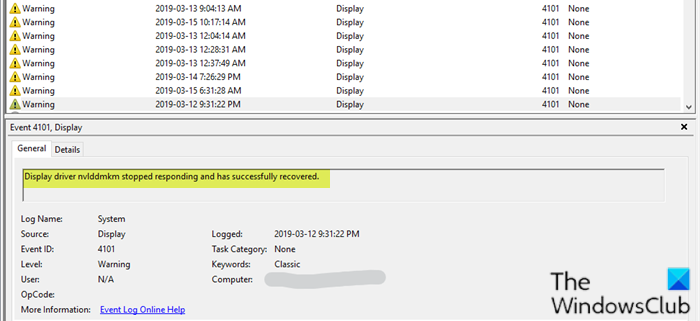

    Some Windows 10 users are reporting that randomly their screen will just go black for a second and come back. When this happens, it usually distorts any video currently on the screen; sometimes, they can resume working on the PC normally. However, when they view the event logs, they see the error message Display driver nvlddmkm stopped responding and has successfully recovered. If you’re having similar issues, you can try the solutions provided in this post to mitigate the issue.
    Display driver nvlddmkm stopped responding and has successfully recovered Display-driver-nvlddmkm-stopped-responding-and-has-successfully-recovered.png

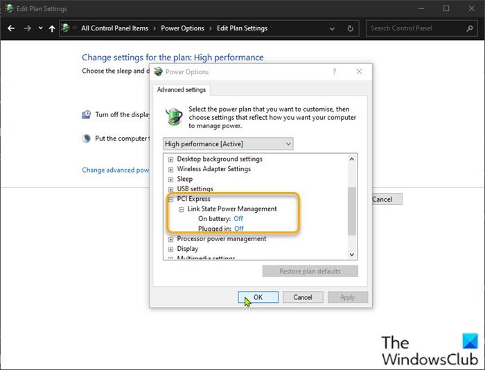

    2] Change Power Management mode
    Display driver nvlddmkm stopped responding and has successfully recovered Change-Power-Management-mode.jpg
    Do the following:
    • Right-click the battery icon on the notification area on the right of the Taskbar.
    • Select Power Options.
    • In the Power Options window, locate your current Power Plan.
    • Select High performance, if that’s not your current power plan.
    • Now, click on Change plan settings next to it.
    • Now click on Change advanced power settings.
    • Expand PCI Express section.
    • Expand Link State Power Management.
    • Now set power saving to Off for both On battery and Plugged in state. This would fix any issues caused by the low power to the video card.
    • Click Apply > OK to save changes.
    The issue should be resolved now. If not, try the next solution.
