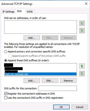

    Hi there, our VPN pushes two DNS suffixes when folks connect to the company network.
    I've got a few users who have an additional DNS suffix of hsd1.dc.comcast.net
    The issue is that additional suffix causes disconnect issues when on VPN.
    I've tried several things including manually removing that suffix from IPV4 and IPV6, and disabling IPV6, but that suffix KEEPS COMING BACK!
    Any idea how to keep that suffix from reappearing in the network settings?
    Thanks
    Ken DNS Suffix for Comcast Keeps Reappearing 1b6307a3-f0a8-468d-9db7-dbaf6ca3b6e2?upload=true.jpg
