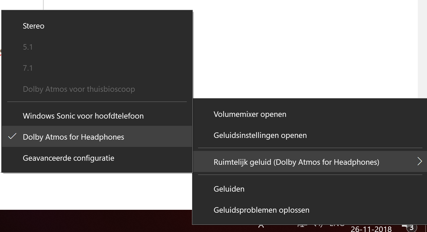

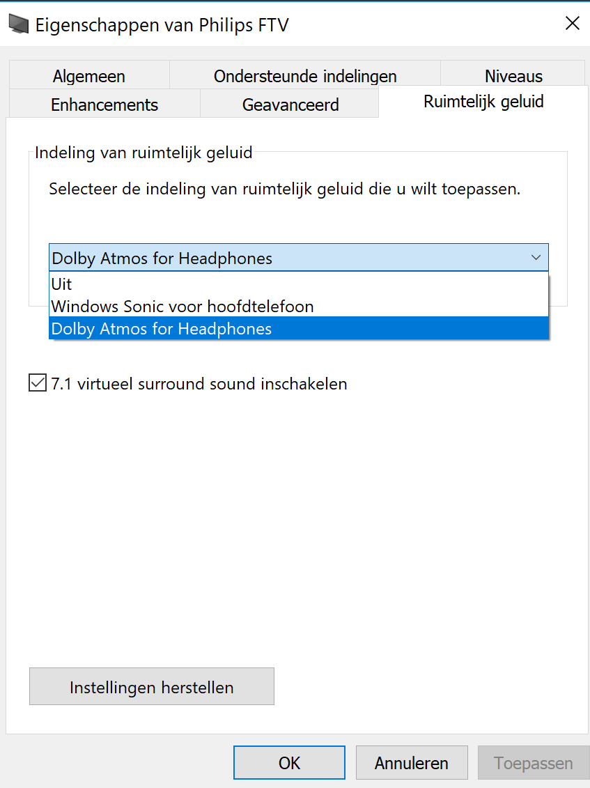

    I have seen other posts regarding this topic, but i still havent figured out how to get my Dolby Atmos - theater mode (via dolby acces) to work on my atmos certified soundbar with my PC.
    So this is what i have:
    - Philips tv (nearly 2 years old)
    - LG SK10Y Soundbar
    - PC
    This is how I connect the movie on the pc to the soundbar
    - HDMI cable from the videocard into the tv
    - The TV is connected to the soundbar via HDMI Arc.
    It seems to work to the point where i can get Dolby Atmos Headphones working, but ofcourse I want Dolby Atmos Theater mode. Sadly that option is greyed out and/or not available in the pc sound settings menu (see pictures before).

    What I have have already done:
    - Checked windows version
    - Downloaded newest Realtek driver
    - Check NVIDIA driver
    - Changed cables out with other HDMI configurations
    - Tried optical cable to the soundbar
    - Tried to see what happens when the ARC functionality is not used.
    To this point i still havent found a solution Dolby Atmos for Home cinema greyed out on windows 10 :(
