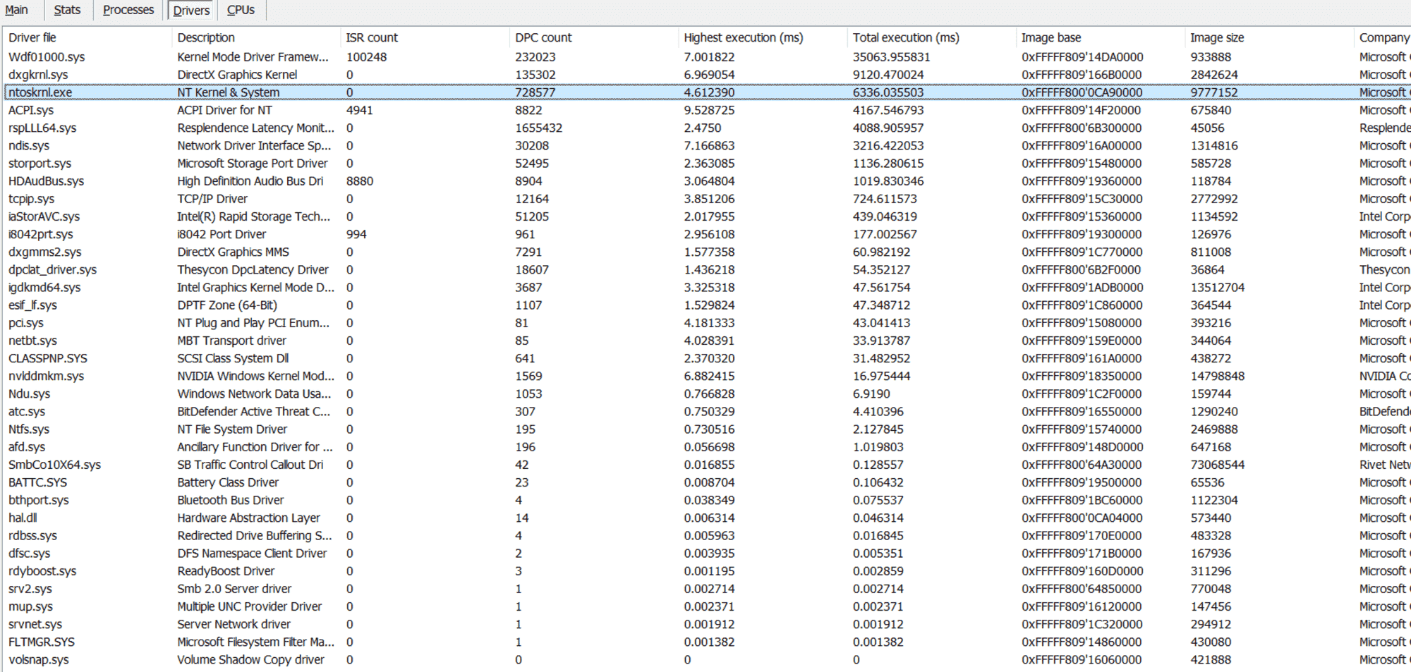

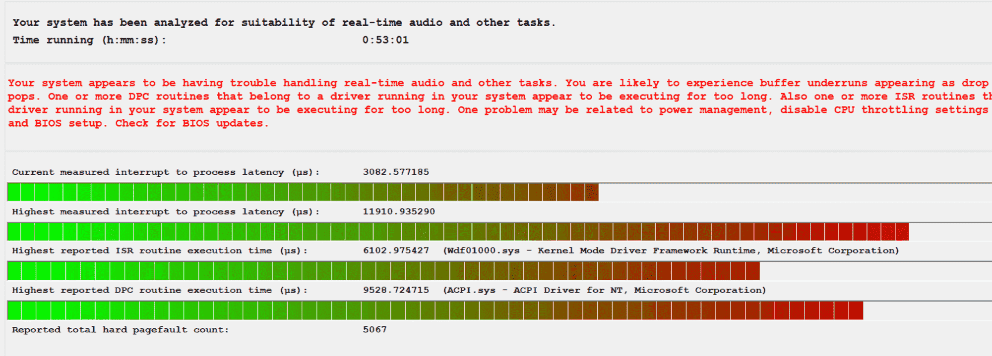

  1. DPC Latency Caused by Many drivers.
    This is a very frustrating issue, and ive tried looking everywhere for fixes but cant find any. Here is some information below and i would appreciate any help. It causes many audio issues and can virtually not listen to any sort of audio.
    DPC Latency Caused by Many drivers. f927db0f-8235-4d8b-bbf1-ad89de1a31fe?upload=true.png
    DPC Latency Caused by Many drivers. 61bf67e7-1093-4ce3-85eb-1564458837c8?upload=true.png

    MEASURED INTERRUPT TO USER PROCESS LATENCIES
    _________________________________________________________________________________________________________
    The interrupt to process latency reflects the measured interval that a usermode process needed to respond to a hardware request from the moment the interrupt service routine started execution. This includes the scheduling and execution of a DPC routine, the signaling of an event and the waking up of a usermode thread from an idle wait state in response to that event.
    Highest measured interrupt to process latency (µs): 11910.935290
    Average measured interrupt to process latency (µs): 27.132701
    Highest measured interrupt to DPC latency (µs): 11897.807078
    Average measured interrupt to DPC latency (µs): 17.903110
    REPORTED ISRs
    Interrupt service routines are routines installed by the OS and device drivers that execute in response to a hardware interrupt signal.
    Highest ISR routine execution time (µs): 6102.975427
    Driver with highest ISR routine execution time: Wdf01000.sys - Kernel Mode Driver Framework Runtime, Microsoft Corporation
    Highest reported total ISR routine time (%): 0.025887
    Driver with highest ISR total time: Wdf01000.sys - Kernel Mode Driver Framework Runtime, Microsoft Corporation
    Total time spent in ISRs (%) 0.033847
    ISR count (execution time <250 µs): 106699
    ISR count (execution time 250-500 µs): 0
    ISR count (execution time 500-999 µs): 7232
    ISR count (execution time 1000-1999 µs): 773
    ISR count (execution time 2000-3999 µs): 341
    ISR count (execution time >=4000 µs): 0
    REPORTED DPCs
    DPC routines are part of the interrupt servicing dispatch mechanism and disable the possibility for a process to utilize the CPU while it is interrupted until the DPC has finished execution.
    Highest DPC routine execution time (µs): 9528.724715
    Driver with highest DPC routine execution time: ACPI.sys - ACPI Driver for NT, Microsoft Corporation
    Highest reported total DPC routine time (%): 0.108837
    Driver with highest DPC total execution time: Wdf01000.sys - Kernel Mode Driver Framework Runtime, Microsoft Corporation
    Total time spent in DPCs (%) 0.224935
    DPC count (execution time <250 µs): 2929387
    DPC count (execution time 250-500 µs): 0
    DPC count (execution time 500-999 µs): 16192
    DPC count (execution time 1000-1999 µs): 4882
    DPC count (execution time 2000-3999 µs): 5093
    DPC count (execution time >=4000 µs): 0
    REPORTED HARD PAGEFAULTS
    Hard pagefaults are events that get triggered by making use of virtual memory that is not resident in RAM but backed by a memory mapped file on disk. The process of resolving the hard pagefault requires reading in the memory from disk while the process is interrupted and blocked from execution.
    NOTE: some processes were hit by hard pagefaults. If these were programs producing audio, they are likely to interrupt the audio stream resulting in dropouts, clicks and pops. Check the Processes tab to see which programs were hit.
    Process with highest pagefault count: chrome.exe
    Total number of hard pagefaults 5067
    Hard pagefault count of hardest hit process: 802
    Number of processes hit: 59

    DevonPoirier, Oct 10, 2018
