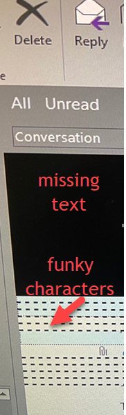

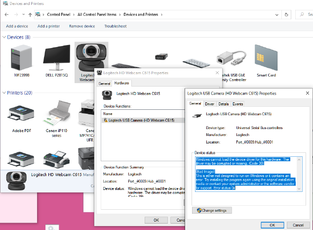

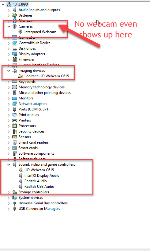

    I have this error with my external Logitech webcam immediately after getting an OTA image of 1909 on a Dell Latitude. I also have very glitchy graphics which I see mostly in email when scrolling or receiving a new email bumping others down. It appears to be a memory issue for the graphics and I cannot screenshot it. The second I interact, the glitched display refreshes. As annoying as that is, I really want my external webcam to function again. The Camera works in my husband's laptop and he has 1909 with a slightly different newer build number than the one I just got. Plus I am not an admin of the machine, but my helpdesk guys said they tried everything and there isn't any hope.
    • Removing the device and drivers and reinstalling does not fix the problem.
    • Roll back does not fix it.
    • Logitech camera software cannot see the camera either.
    • Removing the USB bus device and driver does not fix it.
    • Scan SFC does not fix it.

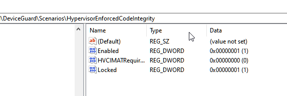

    I found this, but cannot know the safety of it:
    A bug prevents disabling HVCI in GUI
    In Windows 10 version 1803, however, there is a bug that to my knowledge was not fixed until June 2018. Once an HVCI function has been activated, it can no longer be switched off via the Windows Defender Security Center see this post. The workaround is to invoke the registry editor via Run as administrator and then navigate to the key:
    HKEY_LOCAL_MACHINE\SYSTEM\CurrentControlSet\Control\DeviceGuard\
    Scenarios\HypervisorEnforcedCodeIntegrity
    Then set the DWORD value Enabled to 0 see also this Microsoft article and reboot Windows 10. After that HVCI should be disabled and the old drivers or Virtualbox should work again.
