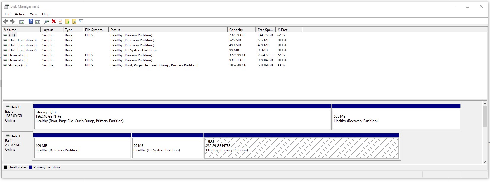

    Hi I hope you can help with this.
    I had to reinstall Windows 10 as it would not boot. I see it has now installed the system on D and made C storage.
    I want to rename them as it causes a problem doing a system backup..IE it wants to back up C but that is storage not system.
    I am not sure how to do this and if just changing it as in re-name won't cause a problem.
    Drives C and D incorrectly named upon instal 3a628510-a460-4875-a8c1-7fd8bd37157f?upload=true.jpg
    Oliver796, Aug 13, 2020

  3. No C: but D: drive has all the data
    Hi Austin,
    To help you with your concern regarding the data on the drive C:, you're seeing the drive "C:" as the drive "D:" because you're booting your computer outside Windows. When booting your computer outside Windows, the system is reading the recovery partition
    as drive C: and the data in the drive C: \ are listed on the drive D: \. Try to boot your computer and try to check again the data in the drive C: \ and see if the data are listed.
    Regards.
    Virfranz Man, Aug 13, 2020
