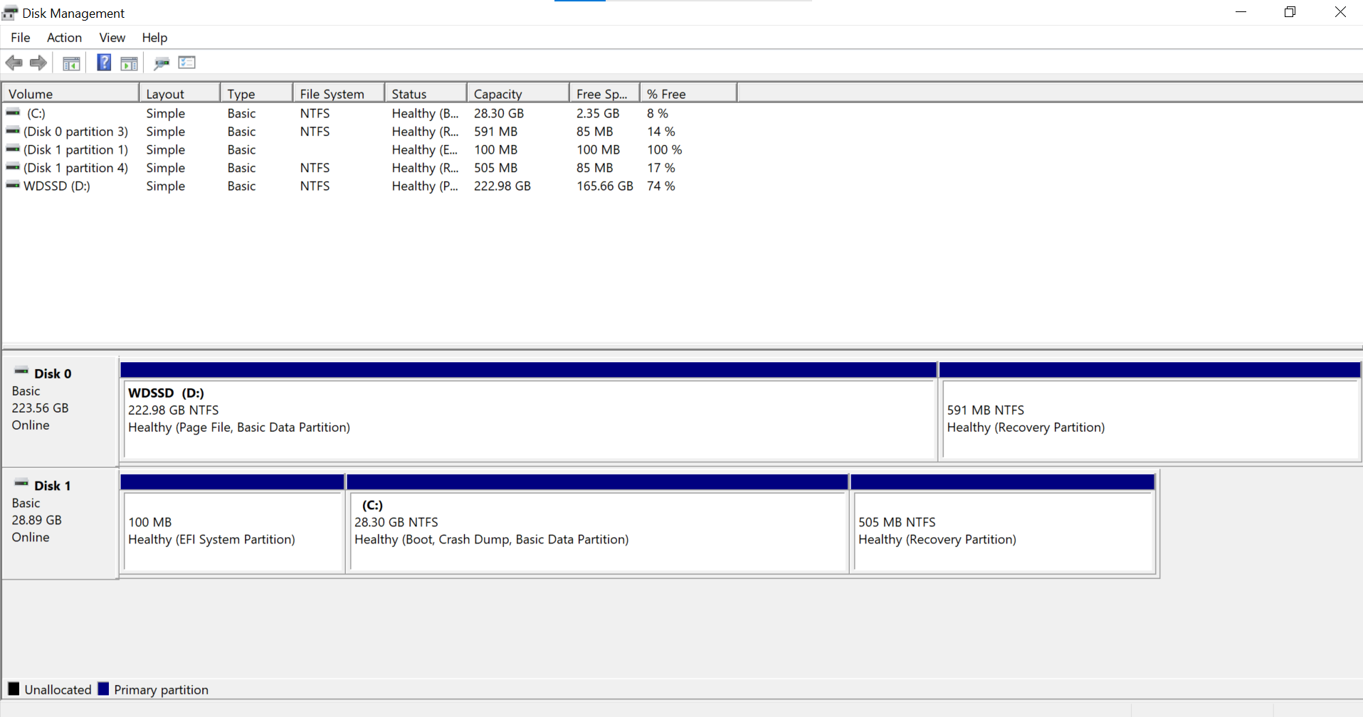

    After reinstalling W10 on the eMMC drive disk 1 in my laptop, the "Choose an operating system" no longer appears, so I can't access the more useable SSD drive disk 0.
    Both drives are showing on disk management. How do I get the choice screen back?
    Dual boot missing choice screen at startup 7ca15f4c-ad4d-4ca5-a5e6-867b2c06f138?upload=true.png
    blackqwertykeyboard, Nov 10, 2020

  4. topgundcp Win User
    Dual Booting with Windows 8.1
    The procedure below will allow you to boot Windows separately or in dual boot configuration.
    Here's what I recommend to do:
    1. Disconnect the drive containing Windows 8.1
    2. Install Windows 10 with one drive connected.
    3. After step 2, reconnect the drive containing Windows 8.1
    4. Boot up Windows 8.1. Open disk management and take a note of the drive letter of Windows 10 OS.
      NOTE: if you boot up Windows 10, then take a note of Windows 8.1 drive letter
    5. Open Admin command prompt and type: bcdboot X:\windows where X: is the drive letter of Windows 10 (Windows 8.1 if you boot from Windows 10 in step 4)
    6. Reboot the PC. You should have a dual boot screen.
    NOTE: To break off the dual boot setting, Win+R->msconfig->boot and delete the none default entry on the list.
    topgundcp, Nov 10, 2020
