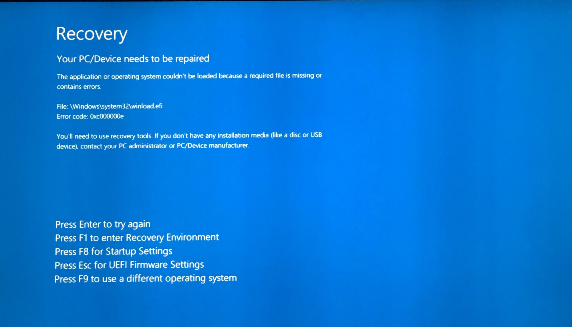

    I'm running Windows 10 (1803) on a HDD (in a laptop). I used the Windows 10 Media-Creation Tool (running from this HDD) to create a bootable installation-USB.
    I just installed a PCIe SSD, booted from the USB, and tried to install Windows 10 (1903) onto the SSD.
    The installation did not finish, as I got an error related to winload.efi. The error is pictured below.
    Dual Boot Windows 10 Two Different Drives fddfe3f9-f7ab-47d2-9d92-1a195315d7d5?upload=true.jpg
    I'm guessing that I'm experiencing a predictable problem. What did I do wrong?
    I can still boot to the 1803-installation on the HDD by pressing F9 from the screen pictured above.
    I'd like to be able to boot to the SSD by default but also be able to boot to the HDD if need be. I'd like to avoid having to take the laptop apart again, if possible.
    All assistance is greatly appreciated.
    Thanks.
    dskrobow, May 28, 2019
  2. topgundcp Win User
    Dual Booting with Windows 8.1
    The procedure below will allow you to boot Windows separately or in dual boot configuration.
    Here's what I recommend to do:
    1. Disconnect the drive containing Windows 8.1
    2. Install Windows 10 with one drive connected.
    3. After step 2, reconnect the drive containing Windows 8.1
    4. Boot up Windows 8.1. Open disk management and take a note of the drive letter of Windows 10 OS.
      NOTE: if you boot up Windows 10, then take a note of Windows 8.1 drive letter
    5. Open Admin command prompt and type: bcdboot X:\windows where X: is the drive letter of Windows 10 (Windows 8.1 if you boot from Windows 10 in step 4)
    6. Reboot the PC. You should have a dual boot screen.
    NOTE: To break off the dual boot setting, Win+R->msconfig->boot and delete the none default entry on the list.
    topgundcp, May 28, 2019
  3. topgundcp Win User
    Dual Booting 2 x Windows 10 OS Drives (Existing Installs)
    It is uneccessary to do all of the above.
    1. Boot up Windows 10
    2. Open Disk Management and take a note of the drive letter of the other Windows 10
    3. Open Admin Command Prompt and type: bcdboot X:\Windows where X is the drive letter noted in step 2
    4. Reboot, you should have a dual boot menu.
  4. Dual Boot Windows 10 Two Different Drives
    dual boot windows xp with uefi windows 10
    It definitely is possible to do a dual boot of Windows 10 with a older version of Windows. There are several steps involved to successfully achieve your objective. For us to resolve your concern, we suggest you follow the step by step process provided by
    Andre Da Costa in the article:
    How to dual boot Windows 10 and older versions of Windows
    This covers installing different versions of Windows alongside Windows 10 in a dual boot environment. Take note though to backup any important files that you have before proceeding with any of the steps to prevent any data loss.
    We look forward to your response once you complete the steps.
    Jordan Dom, May 28, 2019
