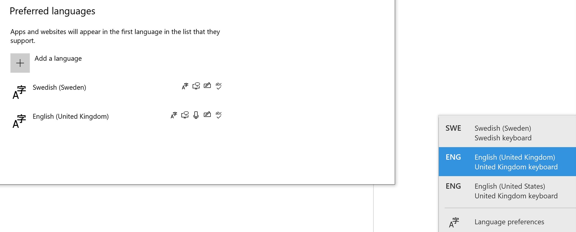

    Hi Community!
    When I want to change input language, using 'window' + 'space', I can now see a 'duplication' of the English option even though my setting says there should only be one English and one Swedish option see image.
    Can someone explain how I get rid of this duplication I haven't had this issue before?
    /Erik
    duplication of the English input language 7f99d228-c5b4-4f0f-83fe-90864f9f4efe?upload=true.jpg
    ErikBergstrom1, Nov 17, 2020
  2. Kari Win User
    Input language duplication reappears all the time
    I was stupid, your screenshot clearly shows you have US English installed *Doh
    Sorry, my own stupidity does not cease amaze me...
    OK. To keep US English input language and remove the UK English, go to Settings > Time & language > Region & language and click the Additional date, time & regional settings link at bottom of right pane:
    duplication of the English input language [​IMG]
    Click Change input methods:
    Click Options for your current display language:
    Remove any unwanted input languages:
    That should do it!
  3. English US keeps appearing as an input language occasionally.
    Hi Mosher,
    I understand the inconvenience caused.
    From the issue description, it looks like you have English Input downloaded and installed in the system. I suggest you to follow the steps below to remove the English input language and check if it helps.
    1. Press Windows key + R.
    2. Type control and press enter to open the control panel.
    3. Type language in the control panel search box and open it.
    4. If English is listed, double click on it and click "remove" under "input method".
    Let us know the result, we will be glad to help if you need further assistance.
