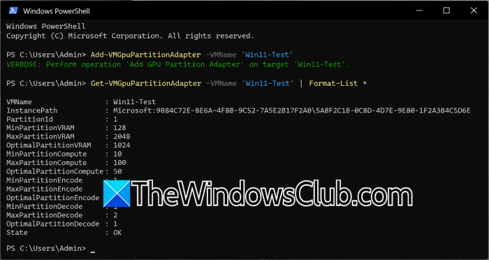

    Enable GPU Partitioning (GPU-P) in Hyper-V on Windows client or server
    Enable GPU Partitioning (GPU-P) in Hyper-V on Windows client or server gpu-partitioning.png ​
    Hyper-V is useful for running another copy of Windows without installing it on separate hardware. The problem arises when the virtual machine requires substantial graphics performance. By default, the VM does not get access to the GPU installed in your PC. In this post, we will see how to enable GPU Partitioning (GPU-P) in Hyper-V […]
