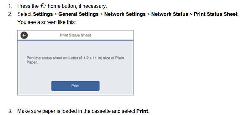

    No, that's not correct. Epson has Windows 7 drivers for the Epson WF-7720:
    https://epson.com/Support/Printers/All-In-Ones/WorkForce-Series/Epson-WorkForce-WF-7720/s/SPT_C11CG37201
    It sounds as if the port configured by Windows is not using the IP address assigned to your printer.
    • Open Devices and Printers
    • Right-click on the icon for your Epson WF-7720 and select "Printer properties"
    • Select the Ports tab
    • Look at the "Port" column on the line that is checked and highlighted.
    • Assuming that you've connected the printer wirelessly, the port should be something like:
      192.168.x.y
      and it should be described as a "Standard TCP/IP Port"
    Now print a "Network status page" using the printer's front panel controls:
    Epson 7720 problem with Windows f701505b-15c4-4704-8bc8-8615741d84df?upload=true.jpg
    If the port shown in the "Printer properties" dialog is not the same as the IP address shown on the Network Status page, that's why you printer is not printing.
    You can fix this by ...
    • Right-click > Remove the printer from Devices and Printers
    • Use "Add a printer" from Devices and Printers > "Add a network, wireless, or Bluetooth printer" and complete the wizard.
    This fix will only work until your printer's IP address changes again, which may happen if you leave the printer powered off for a day or more and connect another wireless device to your router during that time. The proper way to avoid this problem is to
    assign the printer a "static IP." Ask if you need instructions for this or see pages 31-31 of
    https://files.support.epson.com/docid/cpd5/cpd55000.pdf
    Remember that the static IP address must be outside the range of IP addresses used by your router's DHCP server but within the same subnet.
