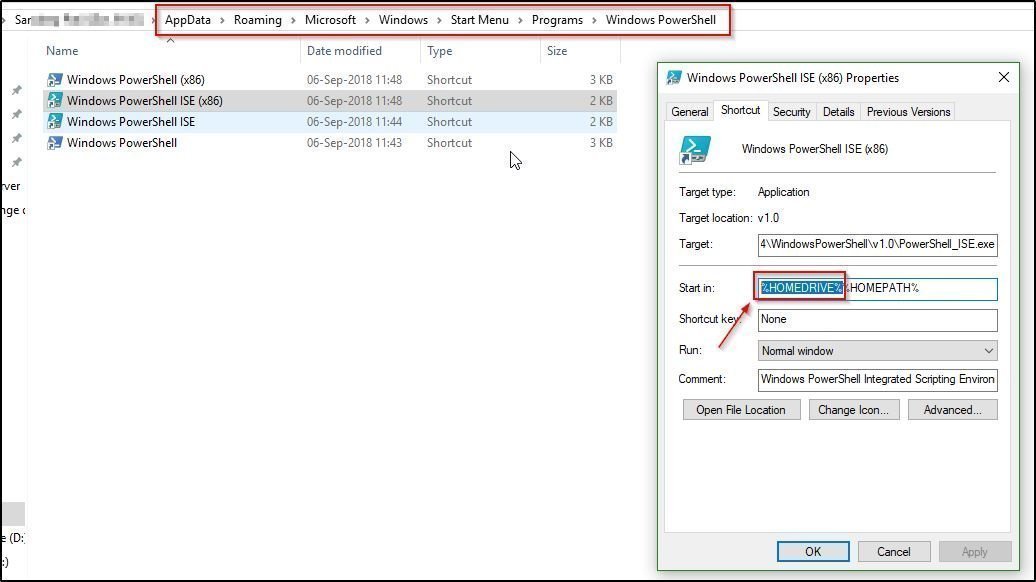

    i have found that, if i search for any application in cortena like CMD, Powershell or Control Panel, i was not able to run a administrator by right clicking on the any applications but it was working fine with normal user profile by simply clicking on Open.
    i made below changes and the issue got fixed. just removed %HOMEDRIVE%.
    Error: 0x800704b3 - Run as a administrator not working from start menu shortcuts 1b441594-9f92-43cc-833b-80bf10035268?upload=true.jpg
