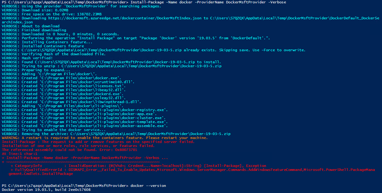

    Dear Community,
    I'm facing an issue trying to install Windows Docker, more specifically its containers feature, to a Windows 2016 server.
    I tried installing Docker using the following set of commands on Powershell ran as Admin:
    Install-Module DockerMsftProvider -Force
    cd C:\Users\s7qzqx\AppData\Local\Temp\DockerMsftProvider
    Start-BitsTransfer -Source https://dockermsft.blob.core.windows.net/dockercontainer/docker-19-03-5.zip -Destination docker-19-03-5.zip
    Get-FileHash -Path docker-19-03-5.zip -Algorithm SHA256
    Install-Package -Name docker -ProviderName DockerMsftProvider -Verbose
    And then restarting the server. The reason why I used the 3 commands in the middle is because the package couldn't be found and therefore installed.
    Anyway, that seemed to work and I'm now able to check Docker version using 'docker --version' command.
    The only thing that failed is adding the containers feature, which gives the following error:
    Error '0x80073701' while trying to install Containers Windows feature 4d9ebe6d-0c07-420d-bddd-0ca9a64dc7cd?upload=true.png
    The same error happens even after restarting the machine and running this command: 'Install-WindowsFeature -Name Containers'.
    I found online that it might have to do with some registry entries in "HKEY_LOCAL_MACHINE\SOFTWARE\Microsoft\Windows\CurrentVersion\Component Based Servicing\PackageDetect" that were created and orphaned and that the solution would be to delete them, but personally I'm afraid to delete Windows registry entries without fully knowing what I'm doing.
    Do you know if there's a precise way to know what to delete and what to not touch, or if there's any other solution/workaround to fix this error and complete Docker's installation?
