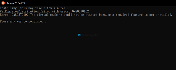

    Error 0x80370102 The Virtual machine could not be started because a required feature is not... the-virtual-machine-could-not-be-started.png ​
    While starting Windows Subsystem for Linux on your Windows computer, if you get an error saying Error: 0x80370102 The Virtual machine could not be started because a required feature is not installed, follow these steps to fix the issue. It is quite common when you disable the Hyper-V and try to use WSL2 on your PC. […]

    "Error" Installing Linux distro in windows 10 pro wsl2
    WslRegisterDistribution failed with error: 0x80370102
    Error: 0x80370102 The virtual machine could not be started because a required feature is not installed.

    I don't have the same hardware you have but received the same error message. I'm running Window 10 Pro version 2004.
    Here's what I found:
    I had Visualization: Disabled and had to go into the BIOS-System Security and enable both Visualization options.
    I also had to install two Vitalization program features for my system, one of which I don't see in your Windows Features screen shot.
    What I selected from Windows Features were: Hyper-V & all sub options, Virtual Machine Platform & Windows Hypervisor Platform
    After restart Debian started with no errors.
