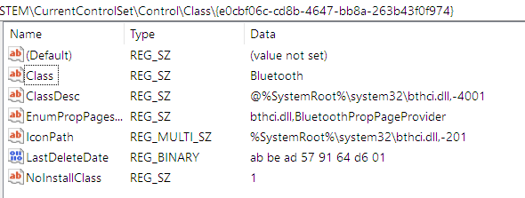

    5. This is when I start looking at the error. Some online sources say delete the
      upperfilter and lowerfilter of the bluetooth in REGEDIT . But I dont even have those value in REGEDIT, cannot locate them and hence this method doesnt work.

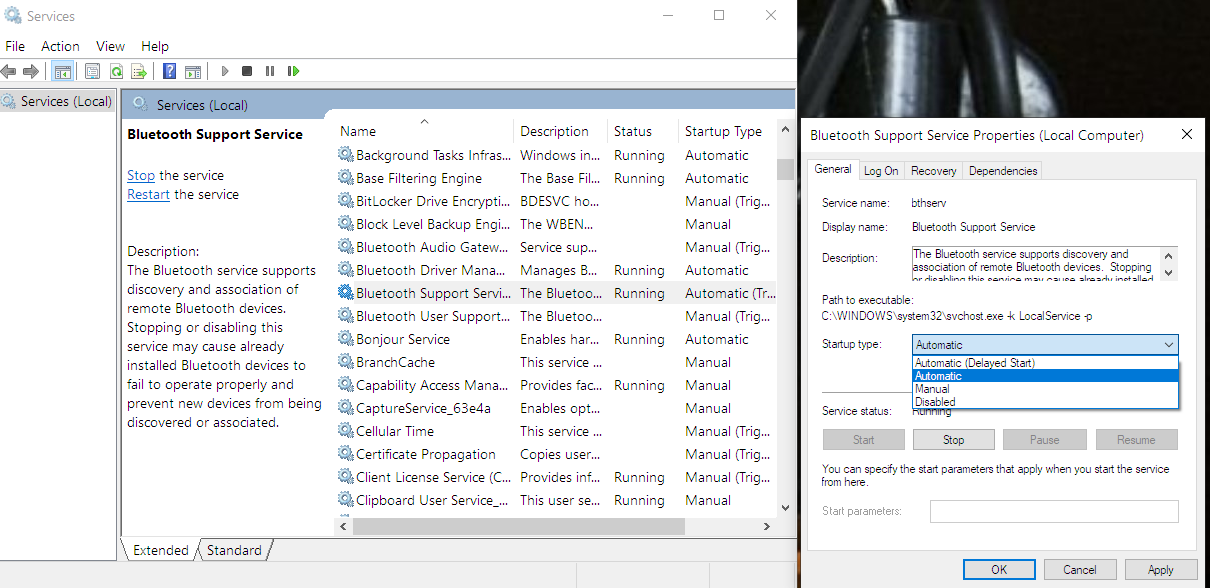

    6. Someone online also mention restarting Bluetooth Support Service in services.msc -- Done that, no use.

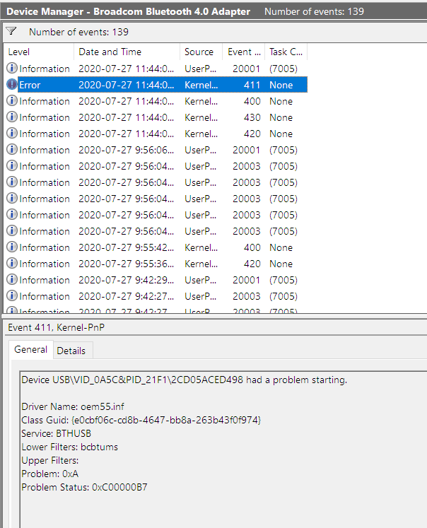

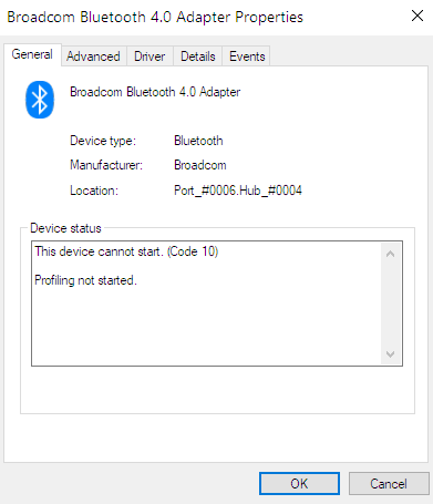

    Error:
    This device cannot start. (Code 10)
    Profiling not started.
    Device USB\VID_0A5C&PID_21F1\2CD05ACED498 had a problem starting.
    Driver Name: oem55.inf
    Class Guid: {e0cbf06c-cd8b-4647-bb8a-263b43f0f974}
    Service: BTHUSB
    Lower Filters: bcbtums
    Upper Filters:
    Problem: 0xA
    Problem Status: 0xC00000B7
    BT Property
    Event Viewer:
    This is how my Regedit look like for the bluetooth:
    Services.msc
