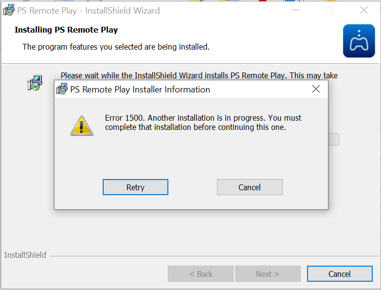

    I'm getting Error 1500 when trying to install or uninstall a program. The program in question is PS4 Remote Play which has been working fine until recently.
    Error 1500 - Trying to install or uninstall a program in Windows 10 01194652-d5e0-4fb3-b917-278169a5338f?upload=true.png
    I have no other installations in progress. Here are the steps I have tried:
    1. Rebooted computer
    2. Ran msconfig and disabled all boot up programs except Microsoft applications. Rebooted.
    3. Ran task manager and tried ending any open installation task and Windows Installer. There are none.
    4. Tried to disable the Installation Reference Using the Registry Editor. There is no registry entry @ HKEY_LOCAL_MACHINE : \Software\Microsoft\Windows\Installer\InProgress
    5. Tried to restart the Windows Installer service. Even when running Services as admin, Windows 10 will not allow me to stop, start or restart service.
    6. Ran System File Checker in CMD.exe "sfc /scannow". Initially error detected and fixed, but this didn't solve my problem. Rebooted. Ran again, same problem.
    7. Ran "DISM /Online /Cleanup-Image /RestoreHealth" in CMD.exe. Then ran "sfc /scannow" again. This didn't solve my problem.
    8. Ran Installation Troubleshooting app from Microsoft. Found a problem, this actually allowed me to uninstall the program. Now the program is uninstalled.
    9. Downloaded a fresh installation file from the Playstation website, same problem, it states the Windows Installer is already running.
    10. Ran install file as Administrator, same problem.
      I'm sort of at a loss for what to do next. Thank you for any help anyone can offer.
