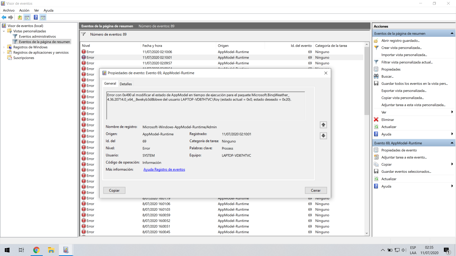

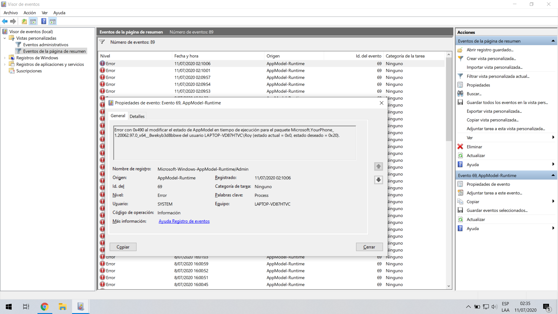

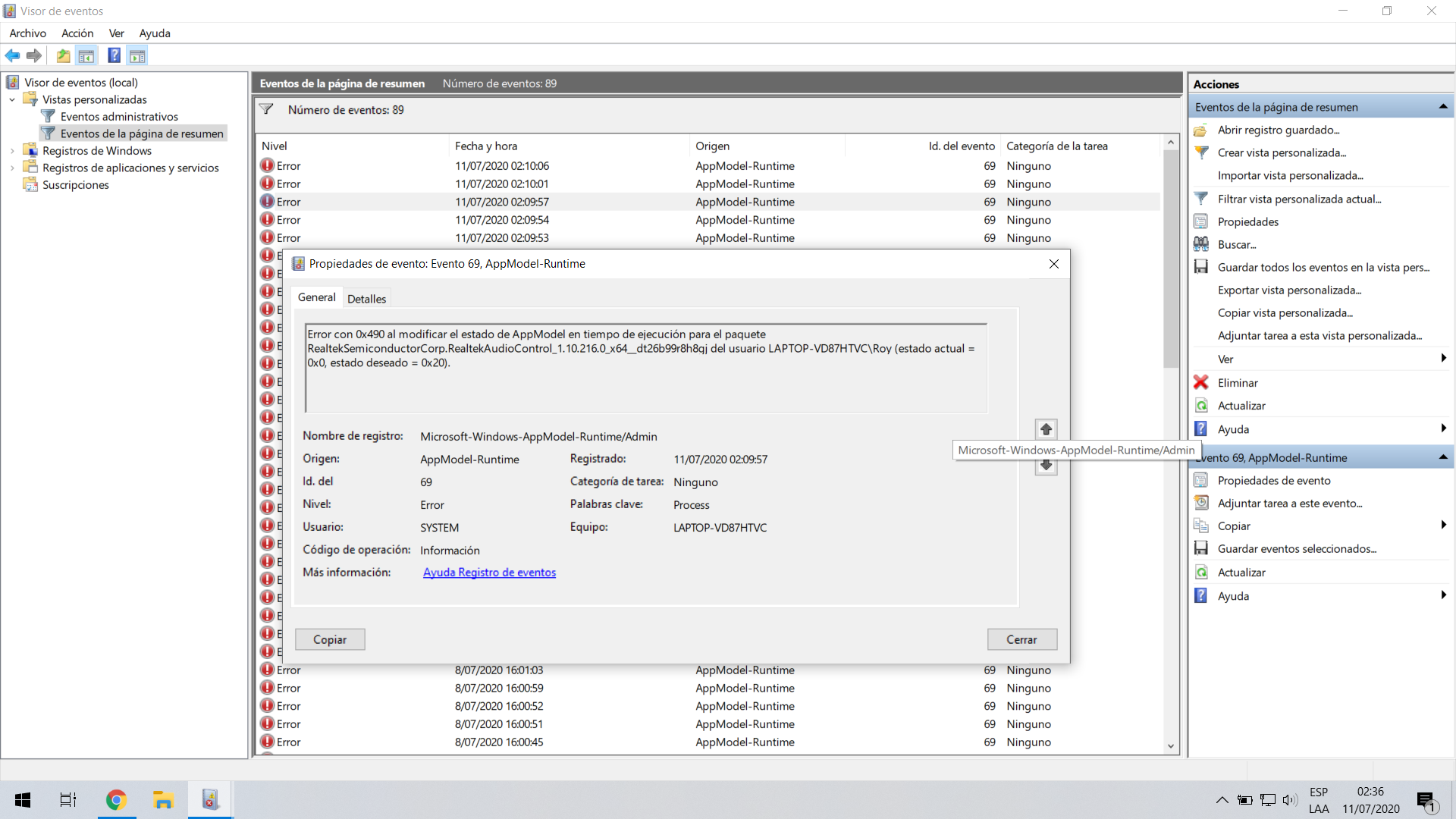

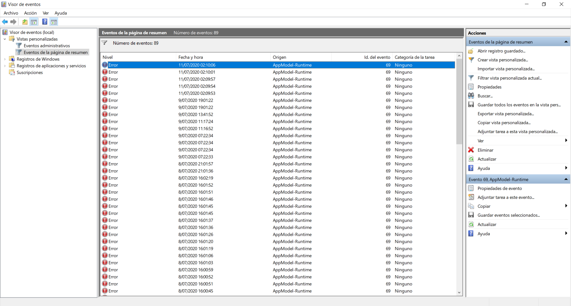

    Hi. I have checked my Events viewer and many errors appeared.
    All these errors mention that Failed to modify appmodel status at runtime on package ....

    Event id 69 Error level: Failed with 0x490 modifying AppModel Runtime status..... caused following Ms Store app access in my case,
    successfully corrected by the simple command Press Windows + R
    and type wsreset.
    BIAoT, Jul 11, 2020
