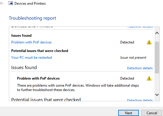

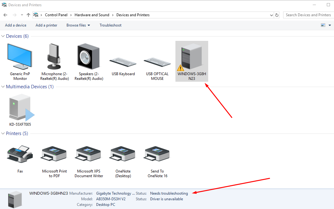

    so i troubleshooted and got this
    Error message "The drive or UNC share you selected does not exist or is not accessible.... 1494d5e4-fe0c-43f8-89d7-9b6bd1f10603?upload=true.png
    which after that i realised something is up with drivers, so i decided to download IOBit Driver Booster which should fix all that cuz it detects

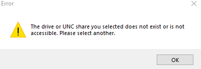

    if drive3rs need to be installed nor need updates so i started to download it and it was fine but when i wanted to install it this occured
    Error message "The drive or UNC share you selected does not exist or is not accessible.... 19d551df-4b71-4d50-8826-da4ecec047a0?upload=true.png

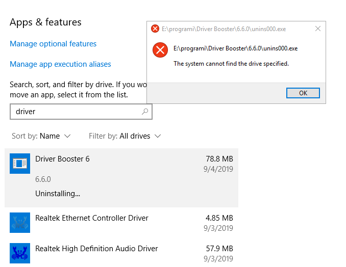

    and i dont have a clue and dont know what to do ive installed the advanced system carep rogram from iobit to and it works i had an older version of driver booster on my pc but i uninstalled it and ist still showing in add or remove listing
    i am not sure if that can cause anything Error message "The drive or UNC share you selected does not exist or is not accessible.... 66cde9b4-28b2-4076-966a-2dc96ef5acf1?upload=true.png

  2. The drive or UNC share you selected does not exist or is not accessible. Please select another.
    Hi Oscar. I'm Greg, an Independent Advisor here to help until this is resolved.
    What works for others is to uninstall the launcher including removing any reference to it in the registry, then reinstall it from a fresh download. Steps here:
    The drive or UNC share you have selected does not exist or is not accessible. - Questions
    - Escape from Tarkov Forum
    The drive or UNC share you selected does not exist or is not - Microsoft Community
    Before editing the registry, set a System Restore point first so you can go back if necessary:
    https://www.windowscentral.com/how-use-system-r...
    If this does not work at first there are other suggestions given that worked for others in the same thread. I can also help you as needed to make the registry change given, and to search the registry for any remaining keys for the launcher following this guide
    to search the registry:
    Search Windows Registry Keys, Values and Settings
    Keep me posted on your progress as I will be here to help until the case is resolved.
