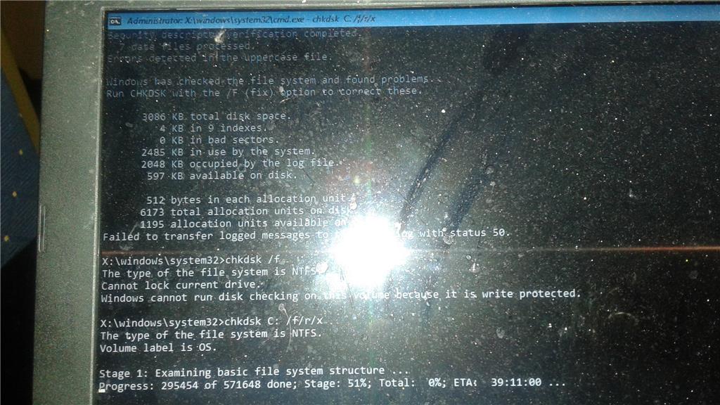

    I just want to know if I can do anything else while using chkdsk to correct the uppercase file errors that were detected.
    JavierGamero, Mar 18, 2019

    Indeed, Windows stopped running, so after the automatic scan made by Windows I rebooted the pc from command prompt and this is wha I got so far:
    I believe this might help.Microsoft Windows [Version 10.0.14393]
    X: \windows\system32>chkdsk /r
    The type of the file system is NTFS.
    Cannot lock current drive.
    Windows cannot run disk checkking on this volumen because it is write protected.
    The volumen is in use by another process. Chkdsk
    Might report errors when no corruption is present.
    Volume lael is Boot.
    WARNING! /F paameter not specified.
    Running CHKDSK in read-only mode.
    Read-only chkdsk found bad on-disk uppercase table – using system table.
    Stage 1: Examining basic file system structure…
    29 file récords processed.
    File verification completed.
    0 large file récords processed.
    0 bad file récords processed.
    Stage 2: Examining file name linkage…
    43 index entries processed.
    Index verification completed.
    0 unindexed files scanned.
    0 unindexed files recovered to lost and found.
    Stage 3: Examining security descriptors…
    Security descriptor verification completed.
    7 data files processed.
    Errors detected in the uppercase file.
    Windows has checked the file system and found problems.
    Run CHKDSK with the /F (fix) option to correct these.
    3086 KB total disk space.
    4 KB in 9 indexes.
    0 KB in bad sectors.
    2485 KB in use by the system.
    2048 KB in use by the log file.
    597 KB available on disk.
    512 bytes in each allocation unit.
    6173 total allocation units on disk.
    1195 allocation units available on disk.
    Failed to transfer logged messages to the event log with status 50.
    X: \windows\system32>chkdsk /i
    Volume label is Boot.
    WARNING! /F parameter not specified.
    WARNING! /I parameter specified.
    Your drive may still be corrupt even after running CHKDSK.
    24 index entries processed.
    4 KB in 9 indexes.
    X: \windows\system32>chkdsk /F
    Volume label is OS.
    571648 file récords processed.
    Deleting orphan file record segment 18210.
    Deleting orphan file record segment 350860.
    Deleting orphan file record segment 350861.
    Deleting orphan file record segment 350862.
    Deleting orphan file record segment 350863.
    13957 large file récords processed.
    Deleting index entry offsymsl.ttf in index $I30 of file 264301.
    660378 index entries processed.
    44366 data files processed.
    CHKDSK is verifying Usn Journal…
    36616 USN bytes processed.
    Usn Journal verifiction completed.
    Stage 4: Looking for bad clusters in user file data…
    Windows replaced bad clusters in file 3787
    Of name \Windows\Logs\NetSetup\SERVIC~2.ETL.
    Windows replaced bad clusters in file 7057
    Of name \PROGRA~1\UNP\Logs\UN3A48~1.ETL.
    Windows replaced bad clusters in file 7122
    Of name \Users\ ROBERT~1\ DOWNLO~1\Twister\TWISTE~1\TWISTE~1.MP4.
    Windows replaced bad clusters in file 7659
    Of name \Windows\Logs\NetSetup\SERVIC~1.ETL.
    Of name \Users\ROBERT~1\AppData\Local\Google\Chrome\ USERDA~1\Default\Cache\f_00052b
    And chkdsk is still running
    I just wondered whether I need a new hard drive. I have been fearing this for some weeks, I have been running chkdsk since the first time I noticed chkdsk detected uppercase file errors but yesterday no errors were detected and today I got the same
    errors detected again.
