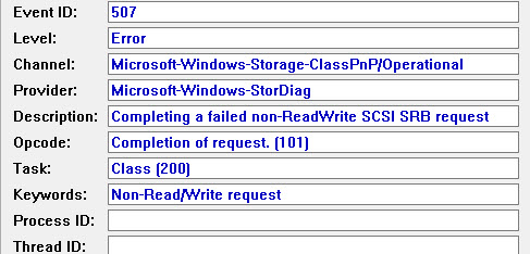

  1. Event 507 - Completing a failed non-ReadWrite SCSI SRB request.
    Since Win 10 1909 dropped I've been getting hundreds of event log messages...
    Event 507 - Completing a failed non-ReadWrite SCSI SRB request. 0fc8a7a3-3473-4998-892e-20918443986d?upload=true.jpg
    ...Device manager does not show problems. I have run DISM, SFC and CHKDSK with no problems highlighted.
    Any ideas?
    Pollensa1946, Dec 20, 2019
