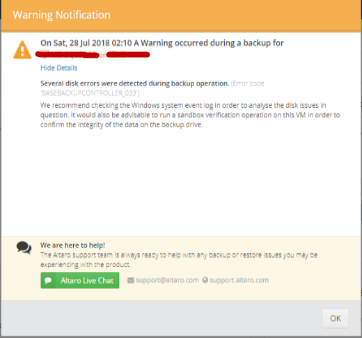

    Hi All,
    One of my server keeps getting this error message and I believe the reason why my Altaro VM Backup are giving me a warning message everyday. Below are the event ID which I think is causing this warning message:
    Event ID 98, Ntfs (Microsoft-Windows-Ntfs)
    Volume ?? (\Device\HarddiskVolume19) requires an Online Scan. An Online Scan will automatically run as part of the next scheduled maintenance task. Alternatively you may run "CHKDSK /SCAN" locally via the command line, or run "REPAIR-VOLUME
    <drive:> -SCAN" locally or remotely via PowerShell.
    Below is the warning message I got everyday from our backup software. I have already raised this issue to our vendor but they told me that this is basically a warning from the OS and I need to fix this on OS level.
    Event 98 NTFS on a corrupted hard drive b0a31d9d-3134-43d5-83b7-091ae7066cb1?upload=true.png
    Does anyone encounter this issue or any knows how I can remove this warning message? I am running on Windows Server 2012 R2.
