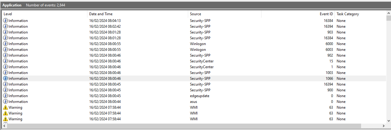

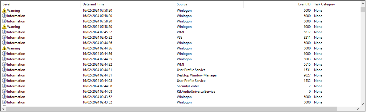

    I've done as advised. I restarted my pc with safe boot and it showed no events of the software protection service. I did not quite get what the "Event Manager" is supposed to be and I couldn't really find it either, I assume this is just the Event Viewer?
    Event ID 16394 and 16384 getting spammed repeatedly in Event Viewer 4nFZAsCTNYtClPSxCJ7z0235VItWG6T78okKM9QoXRUJ2QdfrnCDwnsbsOWh3otFumx%2FzPy5fF%2BEJOouahqpLlbOk%3D.png
    As can be seen on this image in the Event Viewer from 2:43 to 7:58 when I had my PC run in Safe Boot there were absolutely 0 Software Protection events. I then restarted my pc without safe boot on and the issue started again.
    Event ID 16394 and 16384 getting spammed repeatedly in Event Viewer 8x9HJvFMd0oZmq3Sa76F%2B%2FRdlNx%2B4aeKXYQNkddlnNwv2jn9S9wvIYIVORdJhZtQoxk0UKCziW6b9PzGcB1aQvw%3D.png

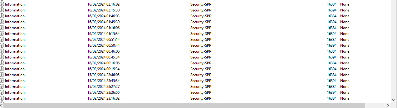

    I'm not sure if there are any other ominous signs here, but the 16394-16384 pairing can already be seen here.

    This is an image before I restarted my PC with safe boot just to show the frequency of the event pairing.
