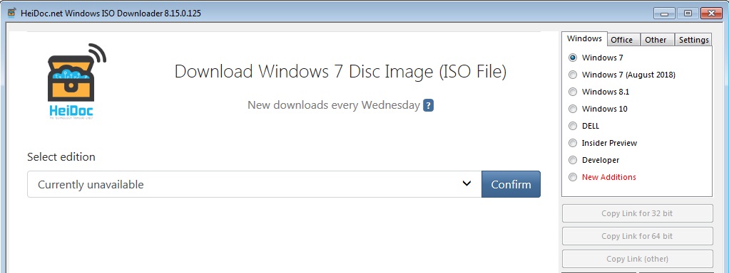

    For quite some time the heidoc option for Windows 7 has been reporting:
    Every time CHKDSK runs at system boot, it completely fucks my D drive. Files corrupted.... 6b332663-8c95-4ae6-8bde-22e8267de6c0?upload=true.jpg
