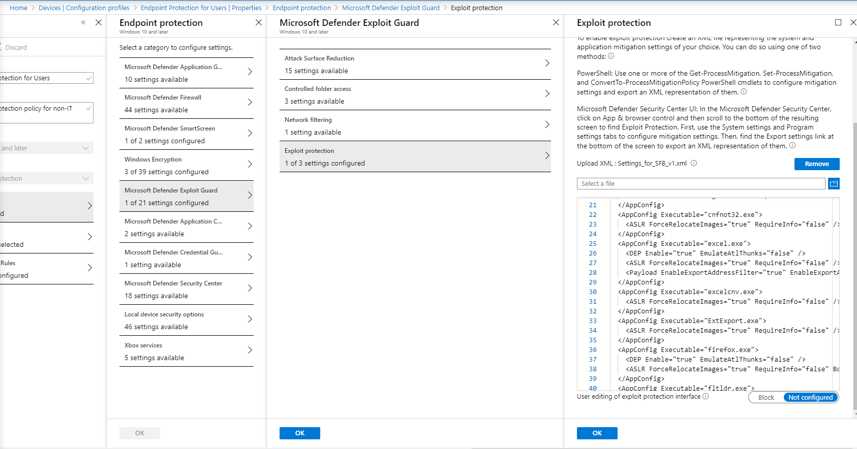

    1. Devices > Configuration profiles > Endpoint protection policy > settings >MS Defender exploit guard > Exploit Protection > added XML config file
    Exploit Protection Intune Configuration Issues with Skype 8a9106f6-a813-473c-b2a9-37f1044c2dea?upload=true.png

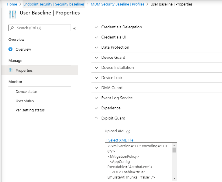

    2 Endpoint security > Security Baseline > Windows 10 Security Baseline > properties > Exploit Guard > upload XML config file
    Exploit Protection Intune Configuration Issues with Skype db7cf524-4bf0-46ef-bcbd-aea478d08739?upload=true.png

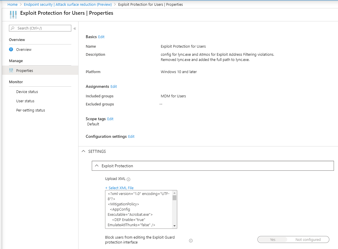

    3 Endpoint security > Attack surface reduction > Policy type: Exploit protection > upload XML config file
    Exploit Protection Intune Configuration Issues with Skype 7338c9ce-b78c-4843-8795-a9c5da587707?upload=true.png
