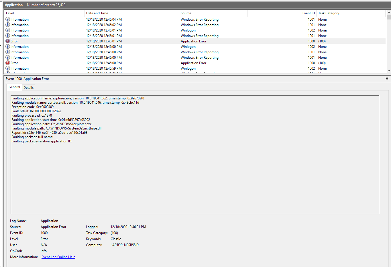

    After the latest windows update, explorer.exe falls into a crash loop and with every restart about half a second, however, the task bar is flashing while the screen is black, this resolves itself after a minute or two. However, this issue still persists after every restart/reboot. It's starting to become a nuisance.
    Of course, I resorted to reverting the update via Startup repair and rolled back to the update prior to windows-10-update-kb4579311, everything works fine there.
    However, windows has a update pause limit which unfortunately ended last night and now the updates are back. I have now decided to seek help from this forum and hopefully find a solution to this nightmare.
    Upon investigating the Event viewer, I came across the error event I have provided a screenshot of this error below for more clarification
    Explorer.exe crash loop after updating to windows-10-update-kb4579311 868a42df-18b9-48b9-a7bf-b1bebce79e89?upload=true.png
    It seems to point out C:\WINDOWS\System32\ucrtbase.dll as the culprit of the errors but after trying a few solutions others have found with the same issue as me, it just doesn't seem to work.

    Windows Update KB4579311 causing explorer to crash repeatedly when logging in.
    Hello SmellyFox,
    I'm John an Independent Advisor and a Microsoft user like you. I'll be happy to assist you today. I understand you have a problem with explorer crash after installing KB4579311.
    It would be best to temporary pause updates until a fix is release about the issue. You can pause updates up to 35 days by clicking "Pause updates" multiple times
    https://support.microsoft.com/en-us/windows/man...
    or to prevent the KB4579311 update from being reinstalled by Windows Update, use the “Show or Hide Updates” troubleshooter to hide the update. Window Update won’t install hidden updates.
    https://support.microsoft.com/en-us/help/318392...
    I would also recommend to send comments and suggestions about the issue through Feedback Hub App. Hopefully Microsoft will notice this and release a fix soon.
    Kindly let me know if this helps or if you have any further concerns.
    Sincerely
    Independent Advisor
