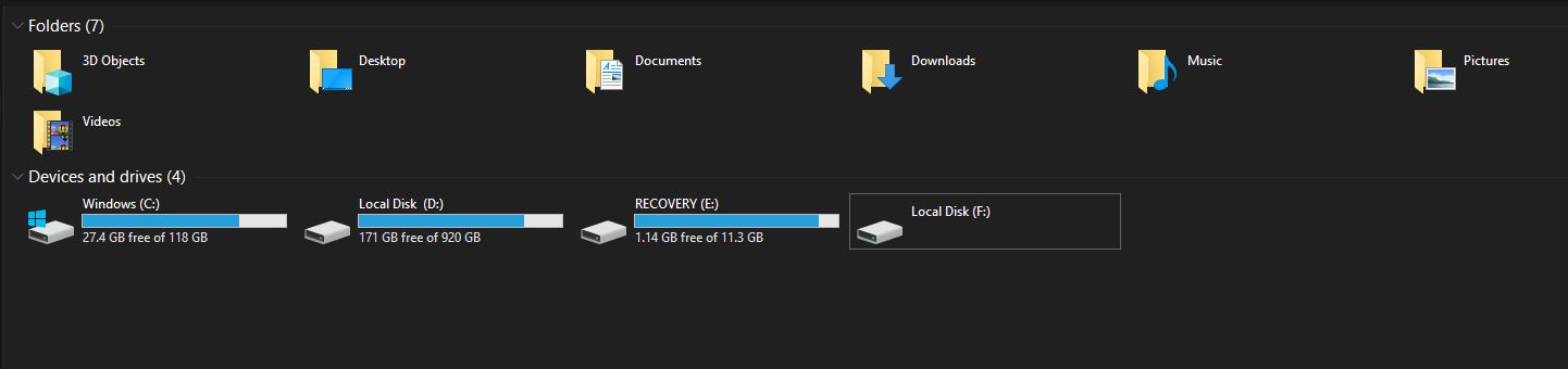

    Greetings,
    I'm in desperate need of help. I bought an WD My Passport HDD about 4 months ago , it seemed to work fine until today , When I connect it to the Laptop it shows up as Local Disk (FExternal HDD showing up as Local Disk (F:) and Not Responding :) and the Storage bar is not shown , As shown in the picture.
    I tried right clicking in order to change the sharing options but explorer.exe just crashes on me.
    I need help because My External drive holds almost 1.2 TB of data and I can't store it anywhere else in my laptop as you can see from the picture so formatting the drive is also out of the equation.
    Any help appreciated.
    External HDD showing up as Local Disk (F:) and Not Responding c136db05-2619-45ab-8469-bb924208e4ae?upload=true.jpg
    DictatorGator, Jun 29, 2019

  3. topgundcp Win User
    local disk f
    This looks like the F: drive is the EFI partition having a size of 300MB. Open Admin Command (Win+X->Command Prompt (Admin)) and type:
    diskpart
    select disk 0
    list partition =====> take a note of the partition # having 300MB. My guess is partition 2
    select partition # =====> replace # with the number in step above
    remove =====> remove the drive letter
    exit
    This should remove the drive letter and won't show up in "This PC"
    P.S
    do not delete this partition, you won't be able to boot.
    topgundcp, Jun 29, 2019
