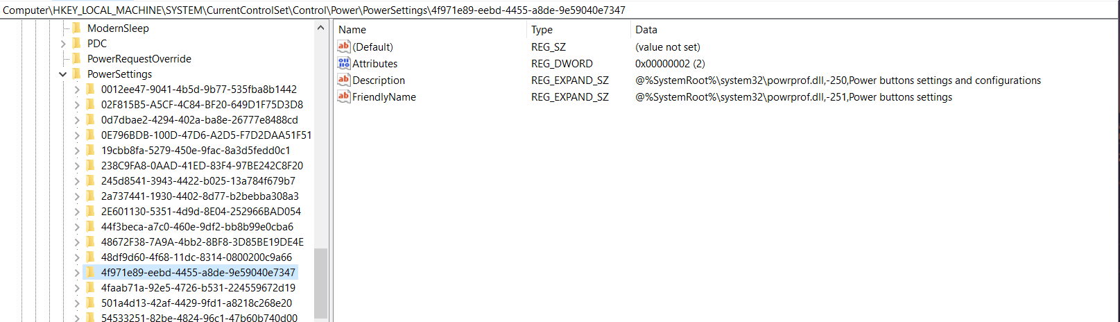

    6. Try to add "Attributes: DWORD =2 file in every "PowerSettings" 's subfolders so they can show up in "power options advanced settings", as shown below:
    External Monitor Via HDMI Won't Turn on After Waking Up From Sleep/Hibernation/Reboot 82b803e2-0ff9-4210-90f8-7e46e494937a?upload=true.png
    --- Nothing has changed in the advanced power options menu.
