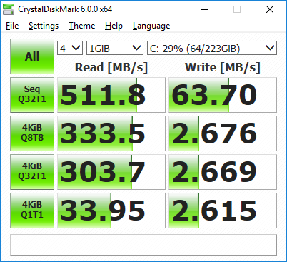

    The SSD in this new system was a re-used SSD from my old system - it's just over 1 year old. In my old system, it had fairly normal read/write speeds of around 500/400mb/s (respectively). However, in this new system, the read speeds perform fine, but the write speeds tank to around 60mb/s. All of these speeds I've mentioned are sequential tests from CrystalDiskMark. The stats get even worse in random performance, with random writes being around 2.5mb/s for every random write test in CrystalDiskMark. Here's an overview of the results:

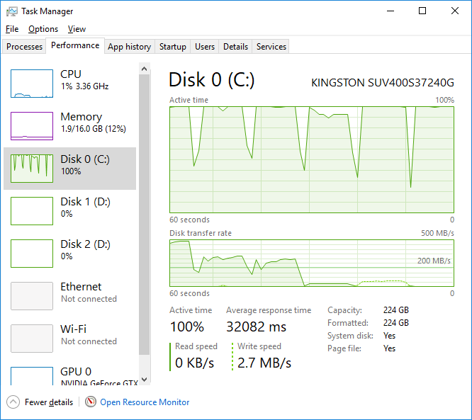

    The read performance seen seems pretty standard, the writes not so much. I also noticed during writes, the processing time for the drive in task manager tanks to 100% and over 30 second processing times. Reads, this doesn't happen and processing times stay under 100ms even in the worst cases.

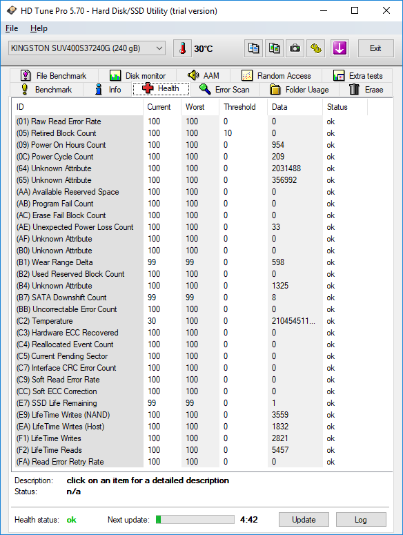

    For those that would like to see the SMART information for the Kingston drive:
