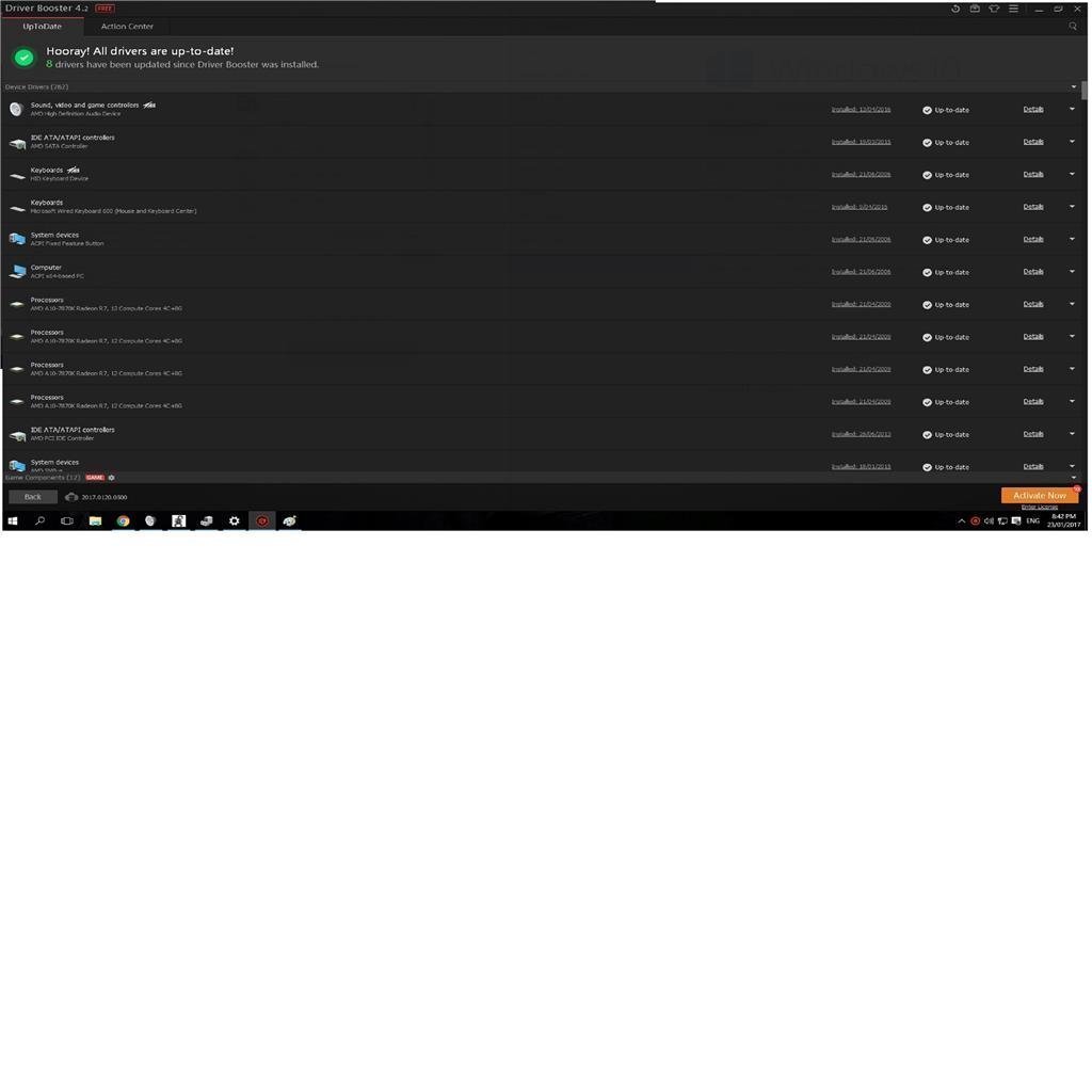

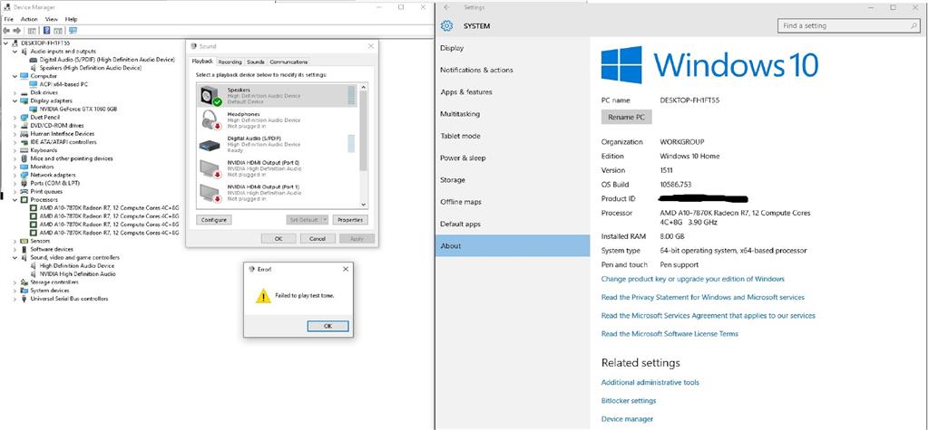

  3. No sound on my computer failed to play test tone
    Hi my computer had sound but just stopped one day I don't know how to fix it.
    when I go to sounds then go test I get an error message saying failed to play test tone.
    i have uninstalled the driver then reinstalled it all my drivers r up to date idk what to do it's been like this for about a month now
    Failed to play test tone (Sound stopped working) - The fix that worked for me. c97fc5a6-8871-4bb4-b573-40cbdd90980b.jpg
    Failed to play test tone (Sound stopped working) - The fix that worked for me. 4da55f72-83ed-4d0f-a3ed-43bdecb0c351.jpg
    TheLastGriffin8, Sep 22, 2018
